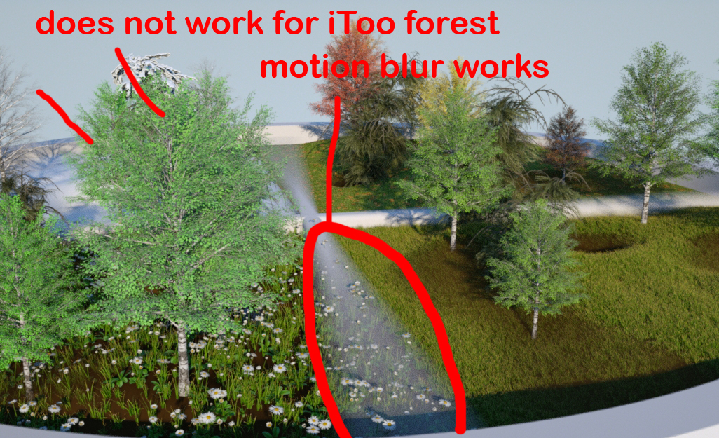

Not sure if these are bugs:
1. I have to check movable proxy or vertex motion blur to see motion blur in octane preview or rendering
I think before when just object motion blur was checked (it is check by default for all objects) i could see motion blur
2. iToo forest. Please see image attached I have trees on this round plate that spins with the trees. The plate does have motion blur but trees do not. I even checked movable proxy, vertex motion blur for all trees including 2 main trees that are used as a reference.
3. also i think moveable is misspelled
octane prop.jpg (53.39 KiB) Viewed 3051 times

coilbook wrote:Hi Karba
forestpack and mutliscatter are 3rd party plugins. There is no way to make full support of them.

What about checking movable proxy for regular objects to see motion blur Is it a bug?
"1. I have to check movable proxy or vertex motion blur to see motion blur in octane preview or rendering
I think before when just object motion blur was checked (it is check by default for all objects) i could see motion blur "
If you don't want to use movable proxy, but want to have motion blur - you have to use vertex motion blur option.
