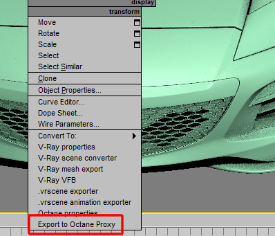

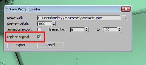

How to convert geometry to proxy
1) Select a geometry (one or several object), right click, Export to Octane Proxy
2) Set folder to store proxy files (file names will be the same as object names), replace original, and other parameters
3) Export
