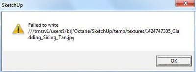

I'm getting the attached error when I open the Octane viewport.
I think the problem has something to do with writeprotection - but can I somehow change the path to my C:\ drive?
It's strange as I have used Octane / Sketchup before with no problems.
ps. plugin for 3ds max design does not have this error.
Error writeing texture

Sketchup stores material textures in zip-like files, so there is no way for Octane to access those materials directly.
That's why Octane4SU plugis has to extract them to tmp location. Lack of valid tmp location causes this type of error.
As for the error, where do you have you copy of Sketchup installed (full path)? And what is full path to your user-folder?

hi fuzzybro
sketchup is installed here:
C:\Program Files (x86)\SketchUp\SketchUp 2014
user path
\\tmsrv1\users$\brj
i just tried sketchup pro 8 (old installation on the same computer), and it does not have the problem.
i have tried to start sketchup as "run as administrator" but this does not solve the problem.
thanks

could it be possible to expand the textures in a user specific path on c:\? this might speed things up and solve the problem?

Is it a network folder?\\tmsrv1\users$\brj

It's a network folder. But it's Strange that my sketchup 8 Pro does not have this issue
