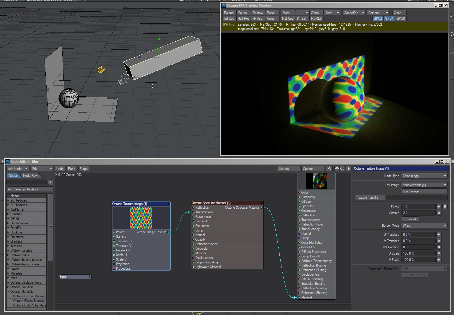

How to project images into space so any object that comes in front of this projector would have some image projected onto it. ( I don't want to use projection nodes since I want to simulate something lika a real world projector)

This light then emmits diffuse light so projection is completely blurred. I need a focused projection on a wall.

You can build a scene with an object that works like a real projector: a box with a transparent film on one side and a small light on the other side. With a small light you can get a sharp projection. Test the attached scene to see if this could work for your project.

BorisGoreta

Thanks man, this is a good solution, I will test how it works in my scene.
I started investigating how real projectors work with a couple of lenses inside but then it got too complicated so I dropped that route.

Please could you share the scene, my projections get out blurry and I have to use PMC with caustics to make it happen.
EDIT: I got it, specular material needs to have fake shadows on !
