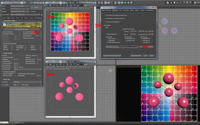

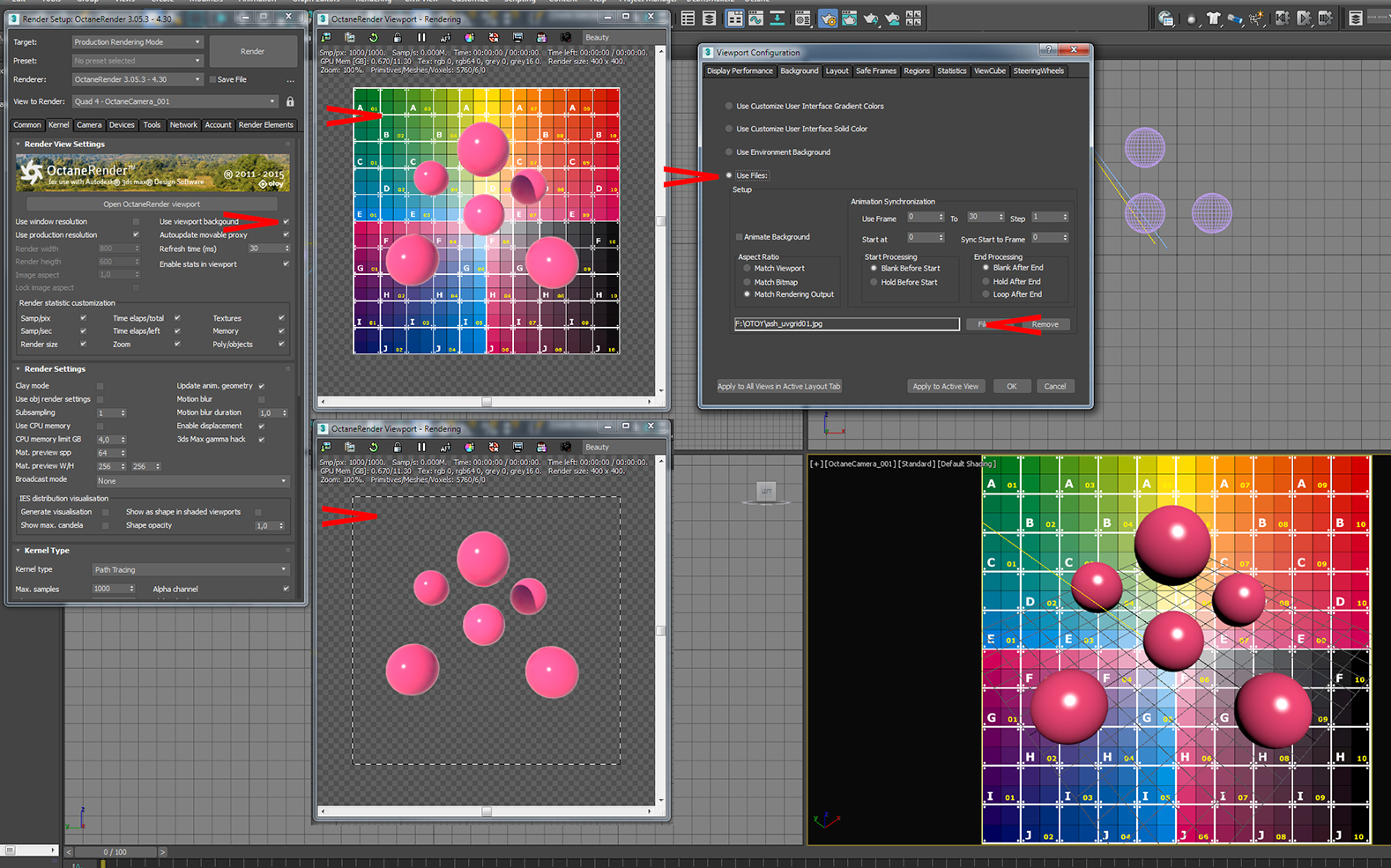

Hi Ramone163,
a screenshot for you.
Regards
Paride

paride4331 wrote:Hi Ramone163,
Regards
Paride
Thank you paride4331.
One problem is that video (sequence images) dont refresh in Octane render viewport. You need to close it and open again to render right frame from video background.

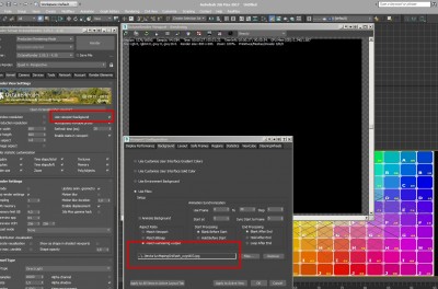

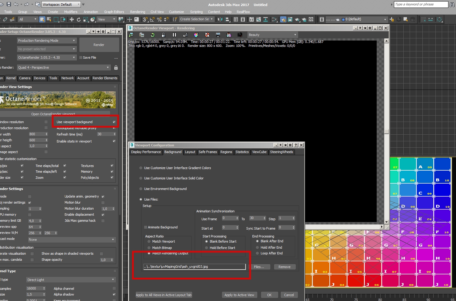

paride4331 , not work for me. have tried many times on different versions of the plugin and never worked. how to be?

HHbomb
Posts: 1438
you need to check "alpha channel" in kernel type section.

paride4331
Posts: 4005
Hi Cathodeus,
you could solve your needs with this workflow:
viewtopic.php?f=9&t=59392&p=304010#p304010
