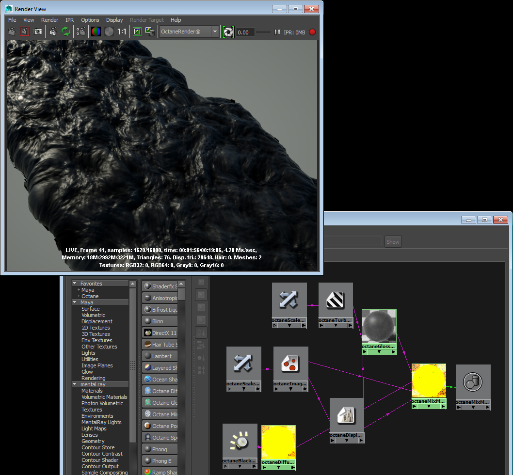

I found some problems with displacement.
1. Displacement is not working with OctaneTurbulenceTexture and other procedural textures,
2. Mix material don't pass emissions when displacement node is connected.
Is it possible to fix it in next release?
Thanks!

Hi, This is a current limitation of octane in general (not just the Maya plugin), only image textures work for octane displacement. I don't know of any plans to expand displacement to support procedurals in the near future sorry.

Ok, I understand.
What's about mix material and emission issue? It look's like a bug.

Sorry. It's working. But only when geometry is global. When mesh is set to scatter or movable proxy there is no any emission...
