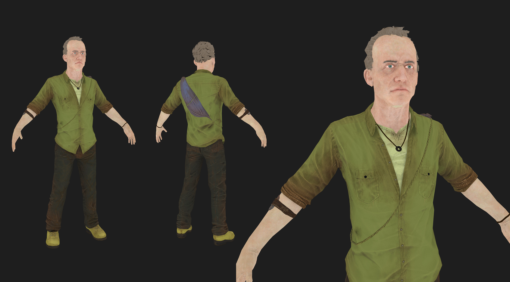

Somebody could help me to generate this king of pass, for 3d compositing.
See image attached
it s a color pass "all textures, but no shadows or ambient"
a sort of reverse of "clay gray mode"
could really help!
thanks

After few tests, i can have a pretty well result creating a scene with no lights
render target with environement white texture
kernel direct lighting in GI type: ambient mode
hope it could help
but only work in open space
some have any other ideas?
thanks

That seems to work well and also select 'colour clay mode' to disable reflections and small crevice shadows.
