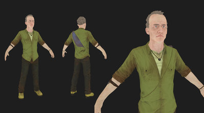

Somebody could help me to generate this king of pass, for 3d compositing.
See image attached
it s a color pass "all textures, but no shadows or ambient"
a sort of reverse of "clay gray mode"
could really help!

After few tests, i can have a pretty well result creating a scene with no lights
render target with environement white texture
kernel direct lighting in GI type: ambient mode
hope it could help
but only work in open space

That seems to work well and also select 'colour clay mode' to disable reflections and small crevice shadows.
