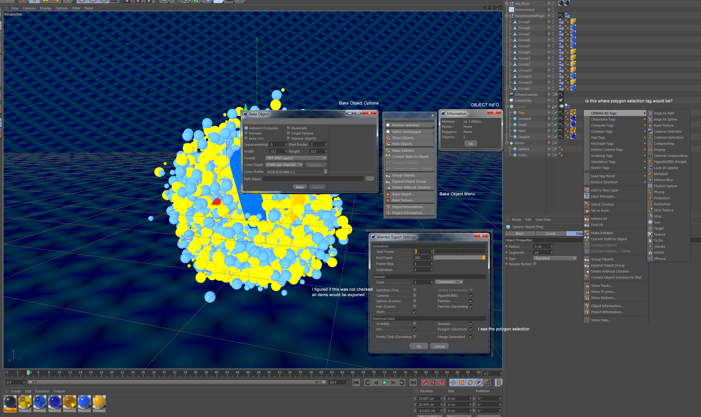

Do you mean assign a polygon tag of some kind to the geom that is under the cloner. (They are already poly spheres under the cloner)But when I look at object information it says these spheres under the cloner have zero polygons so I think I see what you are trying to do.
Am I right in assuming that as long as the poly spheres are under a "cloner" they lose their polygon properties and you have so tag them again? How do you tag them as a poly selection?
(Again sorry for rather vague questions ... it is like learning and speaking spanish in High School and then going to Spain and realizing you know just enough of the language to sound terrible : > ))
The bake object looks to my feeble mind to be a texture bake... the manual makes it sound like you said... but he gui interface wants to write a texture file I think
I have successfully written out an animation rendering through Cinema and Octane. So this is not a high priority...
I am just trying to learn the software a little more : >)
Thanks to you and any others for suggestions on ideas or where in the manual to study.
I have attached a screen shot of the menu items I think you are referring to.
Thanks Again

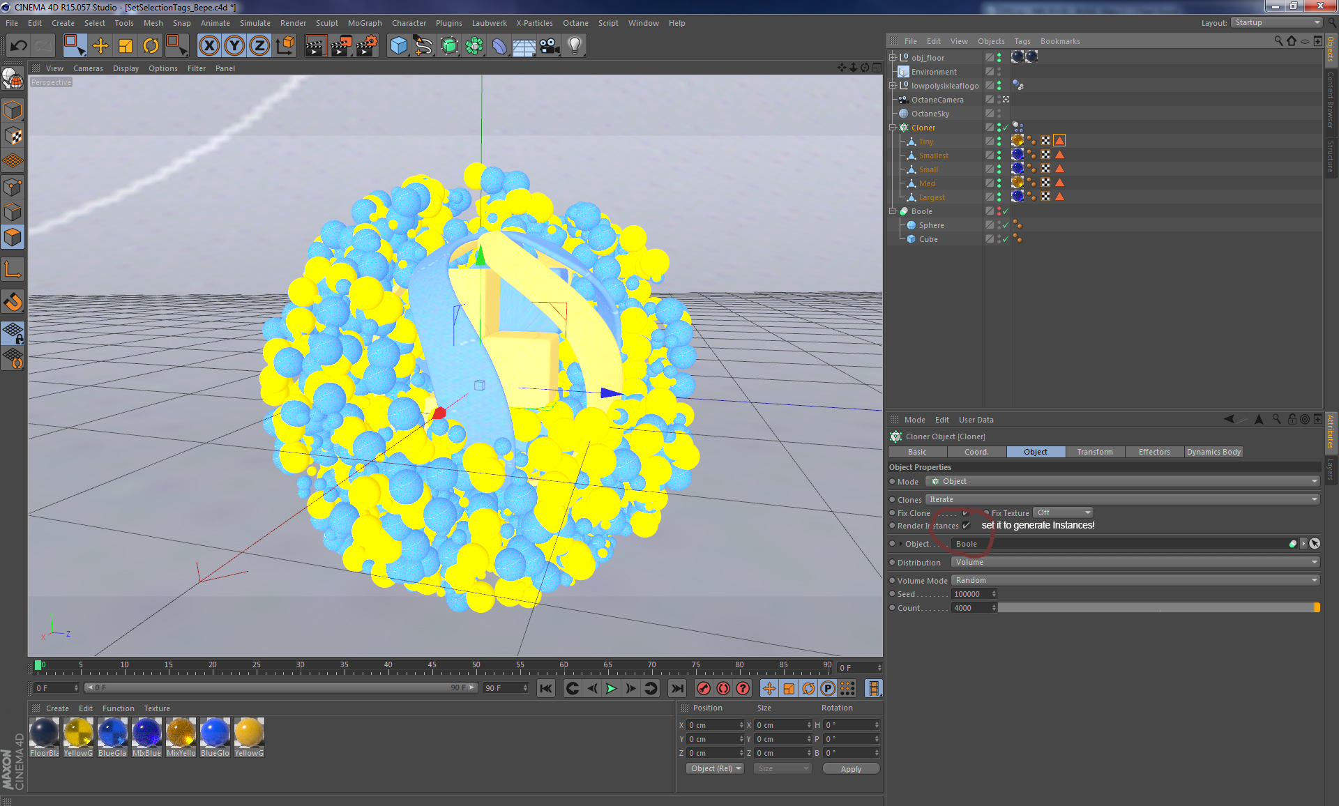

p3taoctane
Posts: 1418
Joined: Mon Jan 25, 2010 12:53 am
Thanks Bepe
Yeah it seems to be something the ABC writer from Cinema controls. If I have merge generated on in my settings in ABC exporter then everything under the cloner is one shader when it hits Octane whether merge materials in the octane preferences is on or not.
If I have merge generated in the cinema settings OFF then again whether or not the octane settings say merge materials I egt thousands of nodes from the cloner
I have attached the scene to see what you get. Its probably a combination I have not tried
Peter
SetSelectionTags_Bepe.zip
(1.04 MiB) Downloaded 171 times

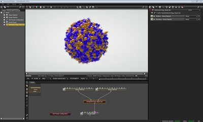

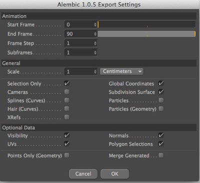

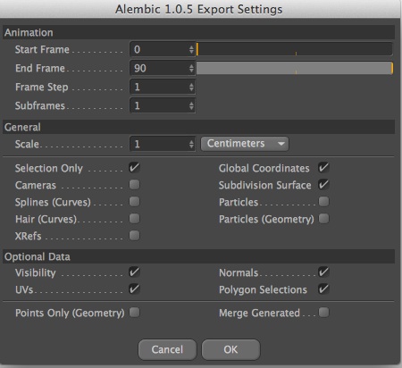

Posts: 10611
hi peter,
you need to take care of the naming of the polygon selection and to set the selection to all the polygons of a sphere.
here is the c4d scene, the c4d-alembic settings and a screenshot of the abc file inside octane:
SetSelectionTags_Bepe2.rar
(593.59 KiB) Downloaded 177 times
ciao beppe
