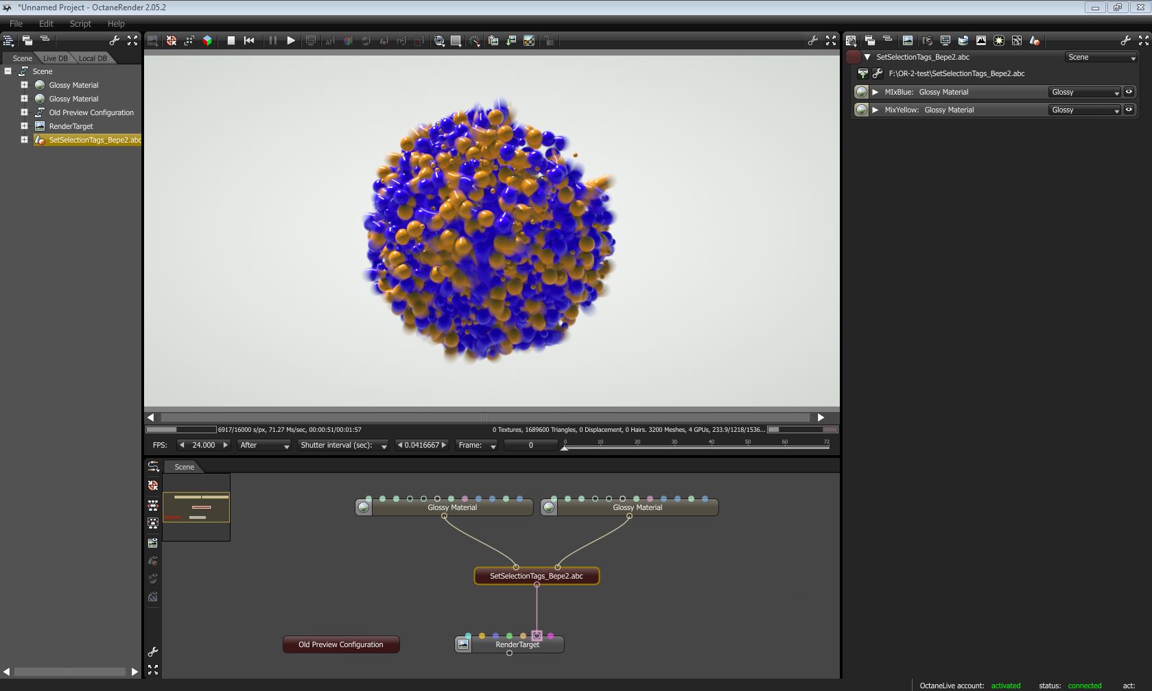

hi peter,
you need to take care of the naming of the polygon selection and to set the selection to all the polygons of a sphere.
here is the c4d scene, the c4d-alembic settings and a screenshot of the abc file inside octane: ciao beppe

Ah ha... naming naming naming... comes to haunt me... the lazyest of namers
Many thanks Bepe
Appreciated the expert help
