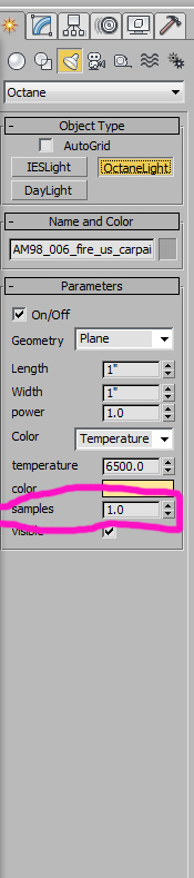

I recently tried new thing. I made my lights very small like a small tiny square, increased power because of it and in the light options where it says samples I changed 1 to 1000 seems like it fixed the noise and fireflies. Maybe it will help

did you try increase light samples to 1000-10000 same button is in mesh emitters. it worked for me
