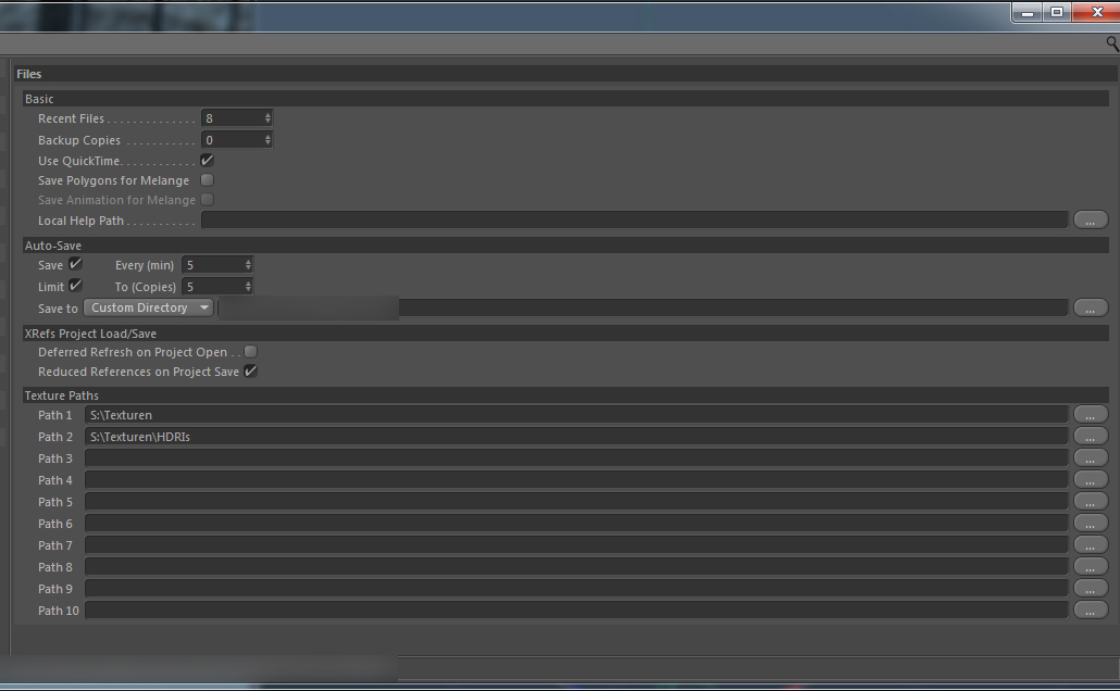

HDRIs don't show up if the path to the folder is saved in C4Ds settings. For Example:
My HDRIs are saved in S:\Texturen\HDRIs and i added S:\Texturen to the Texture Paths in C4D Preferences. Every file which is stored in S:\Texturen\HDRIs won't show up in Octane. Anyway, all files outside this path behave just as you expect them to do. HDRIs loaded from my desktop work flawless.
Adding S:\Texturen\HDRIs directly to the saved paths ends up in the same result, no showing of the HDRI.
Summary: All files i load in are not showing up in the renderings or viewport (altough their little previews in the rendertag show up) as long as ther paths are saved in C4Ds preferences. Copy the files to another location and load them again works just fine. The attachement shows the "not working configuration".
Can anybody confirm this?:)

not a bug! We don't looks this paths. Settings->Paths is for Octane

Hm ok, but i intentionally didn't add the paths for octane. It was an overall action to get rid of the "file is not in project search path" message. I was just wondering that it would affect Octane in this way by simply not using the selected HDRI.
6850k // 32 GB // 1080, 1080 Ti, 2080 Ti // Win 10 // C4D 19.068
Posts: 16068
Location: Türkiye
KeeWe wrote:Hm ok, but i intentionally didn't add the paths for octane. It was an overall action to get rid of the "file is not in project search path" message. I was just wondering that it would affect Octane in this way by simply not using the selected HDRI.
maybe i can add this paths. But i don't want to use to much option. Need to remove other to use one. Two will slowdown some process. Octane could do some output to console window for unfound textures
