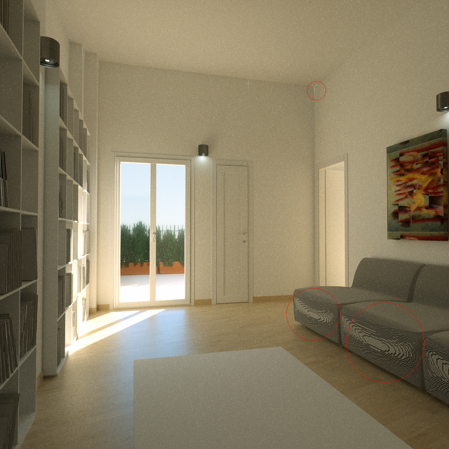

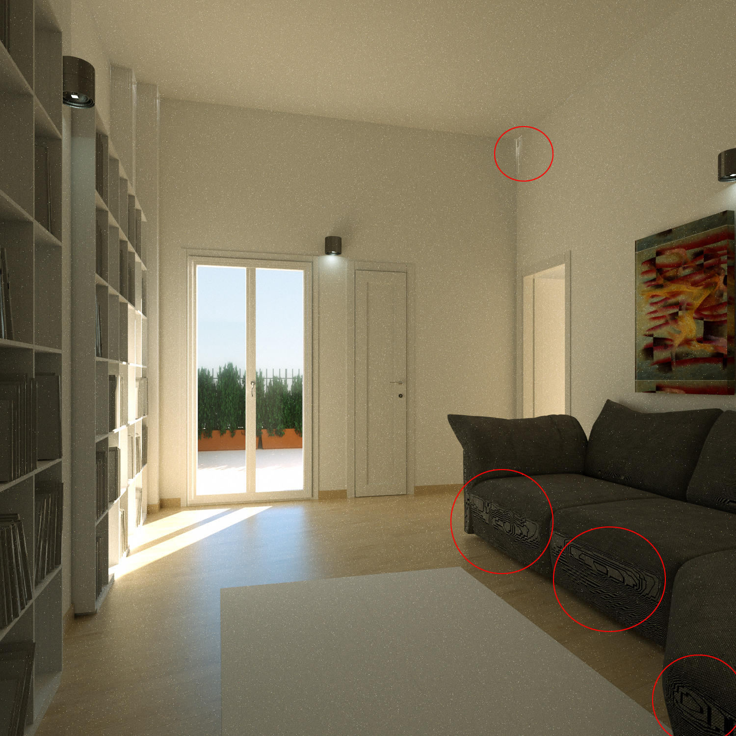

I did this render with version 2.00 and whit the last 2.04 I also changed the sofa but they are problems that I do not understand why.
Such a thing never happened before now ...
is a bug or a wrong setting?
Please help me
Thanks a lot

isn't it a scale or rayepsilion (however it's called) issue? check those..

thanks for reply...scale is ok this is sure...rayepsilion i need to control..

what about the materials? did you use the displacement for the sofa? and the wall material?

No displacement material.. Only diffuse!
Ray epsilon adjust The problem... I don t understand why But Now is all ok!

If you can fix it with rayepsilion it sounds like a scale problem to me even though you think your scale is correct :)
