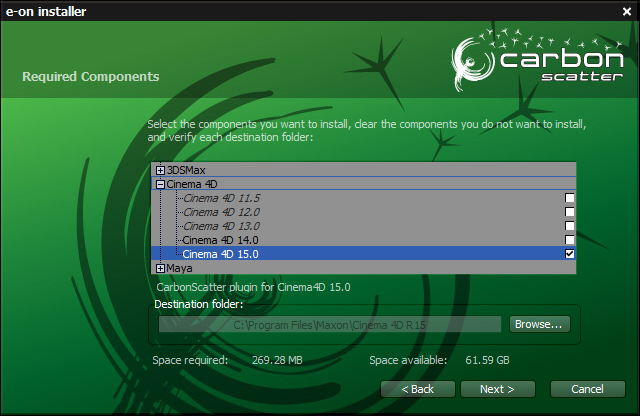

Thanks for the response. I just bought Carbon Scatter, so I downloaded it (version 2.0 build 2103892) from the link they sent me last night. I installed the Cinema 4D R15 version. You are right - there is an update to the one I have - 2103901. I will try it to see if that fixes it.
