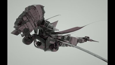

This render goes from 9 mins with 4 titans to 11 minutes with the quadro.
