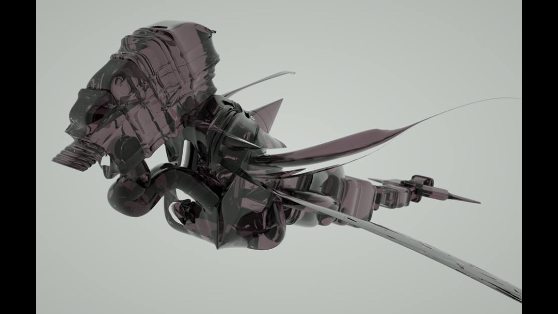

I'm a bit confused on this hardware issue. Cost aside it seems 4 titan blacks win in gpu rendering but for viewports in maya and character animation is it better to have the quadro? My viewport select and rigging seem faster with the quadro? Should I keep my quadro? Is it just a maya glitch? Any advise appreciated. It's intended for professional work. I know this issue is discussed but it's so confusing when ur dealing with multi gpu I spent hours and sill can't decide please help!
This render goes from 9 mins with 4 titans to 11 minutes with the quadro.
