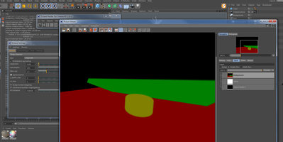

Hi all,
I have notice that anti-alias doesnt work properly where alpha area behind the object. Is this a known issue or i did something wrong?
cheers
Hüseyin

i am the only one who has this problem on earth?

it should be a Octane side problem

maybe premultiply alpha would help?
no luck didnt help.
Should be on Octane side as Aoktar mentioned.

Yes, I've experienced this. You just need to take the alpha pass from your main RGB image and multiply it with this image. Notice the antialiasing is alright 'within' the image. Just it's bad on the alpha edges where the BG presumably is.

pls check with 2.04, may be fixed

In 2.04 same problem :(

NO, check of alpha channel in info kernel

It seems has been fixed. Thanks Ahmet.
