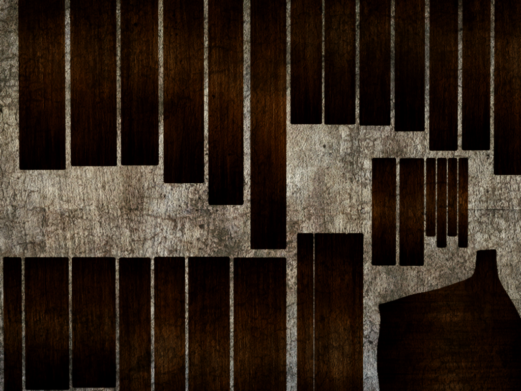

Use a multiply node and plug images into each texture. As long as your "overlay" image has a white background, it should work.
Example:
Base map
Base map
Overlay map
Overlay map
Multiply
Multiply
It doesn't matter which order they appear in the multiply node.
