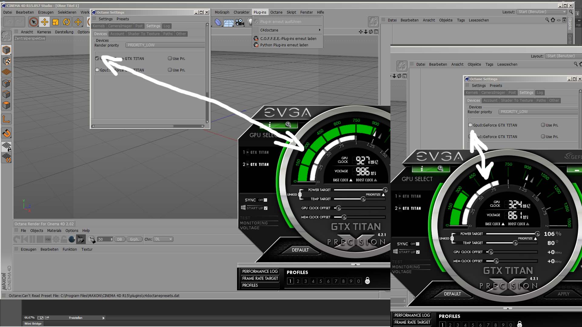

why is the graphics card 70 W, if I start the empty C4D with octane render? Only the Plugin is installed.
Without octane render the card in the idle remains and reverse everything virtually nothing. The Plugin is not installed
It's waste of electricity without End.
Aoktar, can you please look, what this is.
Power consumption Bug OR 2.02

It was different sometimes. Only when octanes Render the titanium Graka took up, stream was used.
However, now stream is already used and one has only just begun C4D and has installed the octanes Render Plugin.
Then my calculator would ordinarily use 130 watts. However, by the bug 200 to 210 watts go by the calculator.
With a titanium. If I switch the second titanium under Devices with to, there are already 270 W.
And this, without something is done.: (
If I switch off both maps, there are 130 watts again.
Look, nevertheless, please sometimes, why the maps are appealed if they do nothing.
With 25 cents / kWh what gathers quite a lot.: (

keep close Octane dialog and Live Viewer, this resolves your problem. Also octane materials fire up Contex and you are requesting some very hard things from me at the moment.
aoktar wrote:keep close Octane dialog and Live Viewer, this resolves your problem. Also octane materials fire up Contex and you are requesting some very hard things from me at the moment.
Excuse if I irritate you, but just exactly this does not go.
There runs nobody Live Viewer, no octanes dialog.
Only one naked C4D surface with installed Plugin.
If in Turkey the Energy price plays no role, here in Germany he is awfully expensive.
I wanted only one answer whether you can regulate this again. Did not want to go for you on the bag.
i tested without any octane materials and windows are closed. It lowers the frequency and TDP of gpu's. So there is no problem as you said. Any change can collapse all workflow of plugin.
It's crazy...aoktar wrote:i tested without any octane materials and windows are closed. It lowers the frequency and TDP of gpu's. So there is no problem as you said. Any change can collapse all workflow of plugin.
Watch the Picture ....
No Plugins installs.
Maybe others can look please also sometimes. I cannot imagine that I only have this. Then this would be really crazy.

I have 2 Titans (first one set as primary).
When Octane Render is paused:
1. Titan: 95% and 80°
2. Titan: 19% and 75°
I also think, that this is not normal!

My CPU does nothing at all. It is simply about the GPU which, as the pictures point, works, although nothing at all is to be done.
