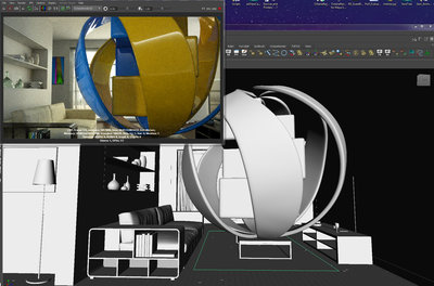

I have problems with 2.02 plug-in with camera:
please, see this image:
I used octane camera, and I have the same problem even if I open scenes made by 1.55 plugin.
Thanks for help

It looks like you have the "resolution gate" problem.
I had this problem many times. When you set your setting to anything else than "fill", octane does not match the settings.
I've tried evry settings, the only one that works is "resolution gate : fill".
But maybe it is something else.

It is already fixed.

I just installed 2.02-4.1 and have same Camera issue not rendering what is in modeling viewport.
After installing the 4.1 version my saved bookmark is not longer what it used to be. I am zoomed the the hell in.
I did not have this issue in 2.02-4.0
Peter
JimStar
Posts: 3812
p3taoctane
This was reworked to more properly reflect the resolution gate of rendered image in Octane. Just enable the "Resolution gate" mode in viewport camera settings and you will see the exact fit.
