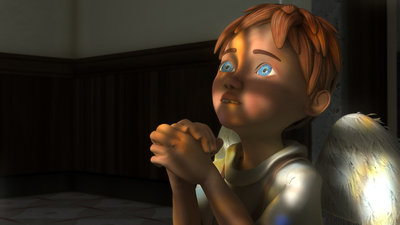

To be exact, these are the effects I am trying to acchieve:
http://www.flickr.com/photos/ac4lt/11199149/
http://www.jacobsen.no/anders/blog/arch ... rtres.html
This is the desired effect. The light passes through Stained-glass, and fall on the character/ object.

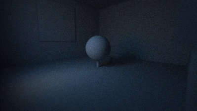

This is the attempt, by setting glass geo (single plane) to Specular, and attach the image texture to "Transmission."
The image is the same one that eliminates the kid character in the first picture. Though, it doesn't achieve the desired effect.

radiance
Posts: 7633
this si due to sunlight not passing trough glass yet, you need to use an arealight outside,
maybe place a plane behind your window at a fair distance to make it more parallel.
Radiance
vanlicht
Posts: 139
Joined: Fri Feb 26, 2010 8:19 am
Location: Los Angeles
I tried using the area light instead of sunlight in Pathtracing mode. Still, Area light gives similar result to what sunlight does. In addition the render seems very inefficient this way at this moment.
Windows 7 64bit | Maya 2010 64 bit (main) | Maya 2011 | Intel i7-920 | Nvidia Quadro FX1800 | Nvidia GTX480
radiance
Posts: 7633
vanlicht wrote:I tried using the area light instead of sunlight in Pathtracing mode. Still, Area light gives similar result to what sunlight does. In addition the render seems very inefficient this way at this moment.
yeah, that's one of those scenarios where pathtracing is'nt good for. you're rendering caustics.
the new render kernel in v6 will make this much easier.
