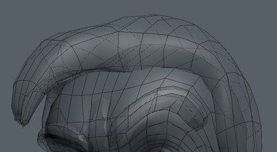

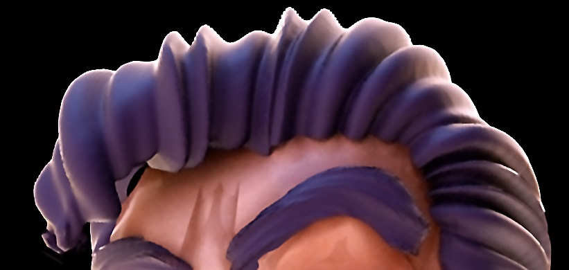

For exemple, they have a option which call Sub-polygon displacement
it's very powerful tool when you have a low poly mesh and you want make details by using your displacement map.
with this option you can subdivide your sub polygon displacement to make illusion your mesh is highly detailing but is not, It's just an illusion.

hey,
the subpolygondisplacement is subdeviding the geometry pretty much the same way as the hypernurb (now "subdivision surface" generator) does.
this happens after you klick on render but its not an illusion as described like bumpmapping, the object realy gets subdivided and the surfaces are displaced right before rendering starts
