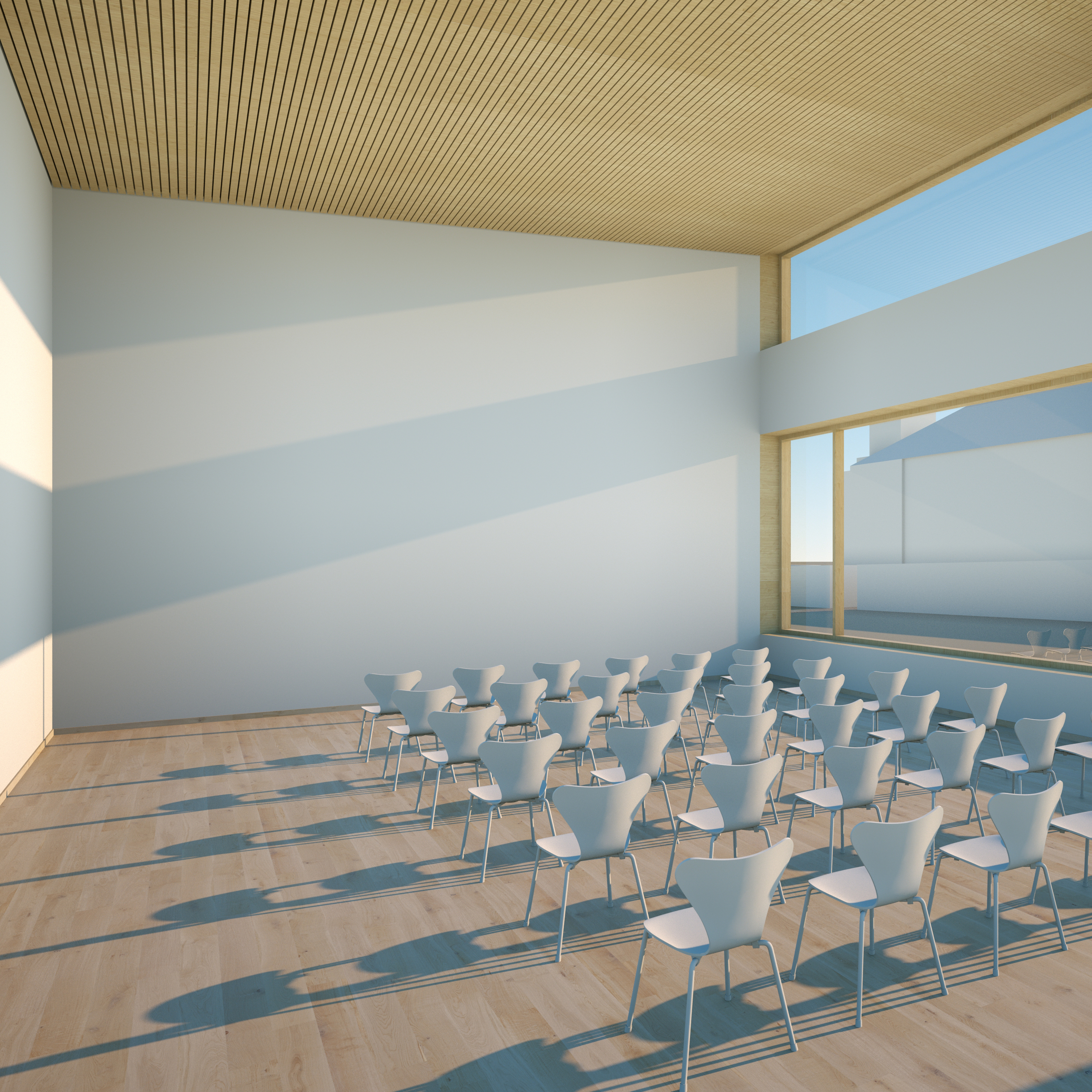

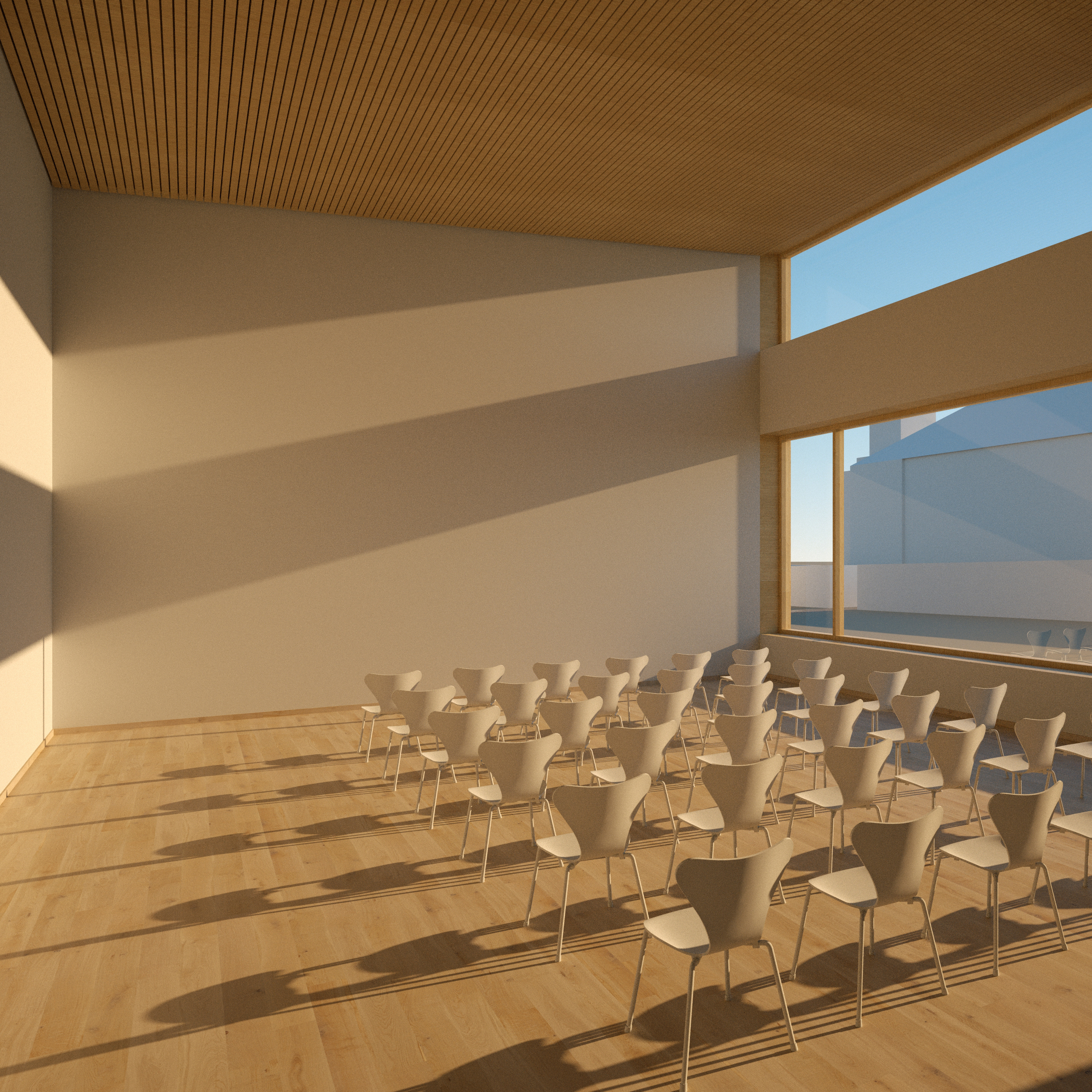

I'm doing an interior and could use some quick and dirty tips to optimize rendertime/quality.
I have attached an Direct Light version and a PMC version.
The DL took 10min to render and the PMC version 46min to render.
I find the DL a bit to 'clean', but the PMC to slow - is there some way to improve DL quality or a trick to optimize PMC?
Both renders had 400 samples.

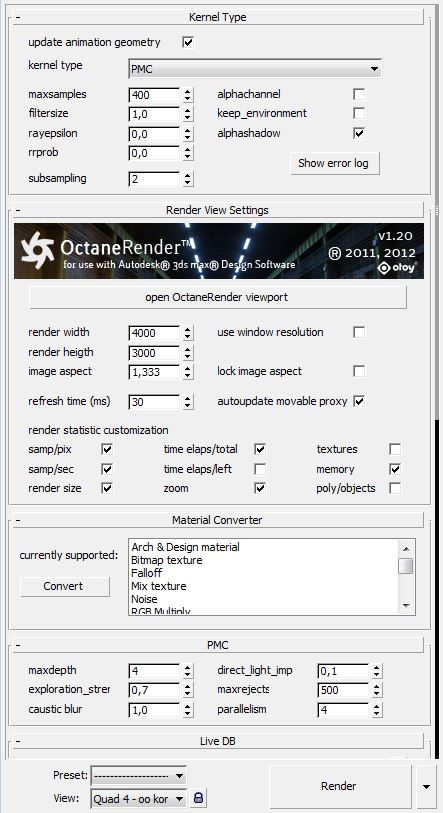

I have added the PMC settings.

Posts: 10581
have you tried the Direct Light kernel in diffuse mode instead of ambient occlusion mode?
should be faster and cleaner than PMC with a scene like that ;)

Jorgensen
Posts: 872
Joined: Sun Jun 30, 2013 10:53 am
Hi bepeg4d
Just tried using diffuse mode, and Direct Light sure looks nicer, but it then gets slower than PMC - can this be right?
