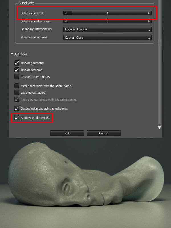

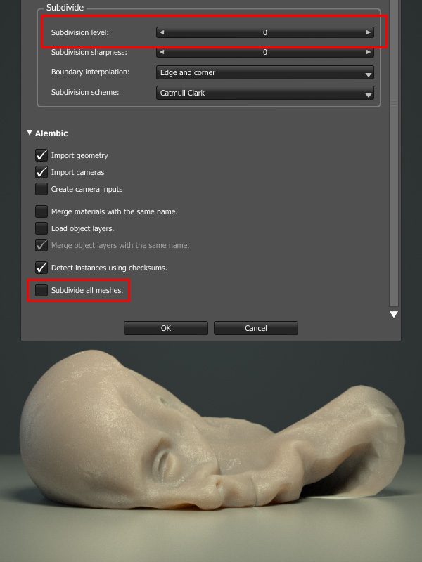

I found a weird problem when trying to subdivide an alembic file with a sss material.
The image above is the scene without any subdivision.
The image below is with one level of subdivision. As you can see the shader changes completely and the material becomes gray! :?
It happens only with alembic. I tried the same scene as OBJ and the subdivision worked fine with no side effects on the material.
Any idea? :?

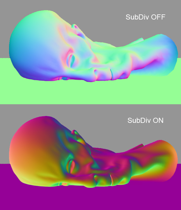

roeland wrote:Can you post a render of the interpolated shading normals output of the info channels kernel, without and with subdivision?
Super-Roeland as usual knows his stuff... 8-)
The render of the normal does indeed get fucked up with the subdiv ON.
roeland
Posts: 1823
The normals are flipped when subD is enabled, but I can't reproduce this issue here. What are the other settings under the common import preferences?
