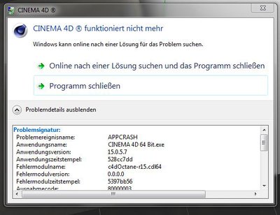

Hi Ahmet,
got a problem here!
Octane crashes as soon as I try to adjust the "Movie End Frame"
in the Image Animation Tab.
regards
Mike

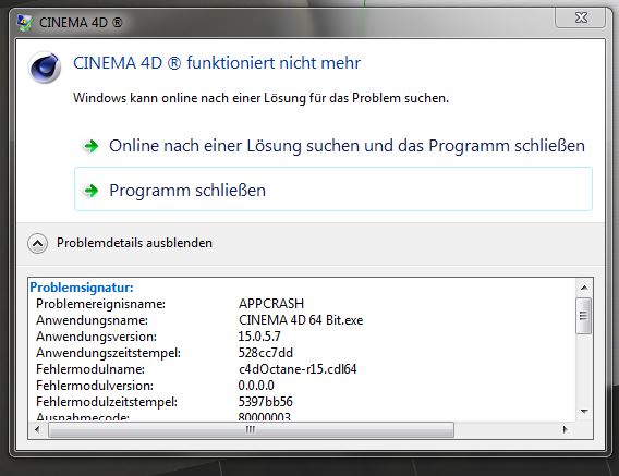

Hi Ahmet,
imagesequence is a jpeg-sequence loaded in image-texture.
It happens every time when I click on "Movie Start Frame"
or "Movie End Frame" and enter a value. After that Octane/C4D crashes.
Also crashes if not an image-sequence, but only one bitmap is loaded.
Can you replicate this crash?
regards
Mike

Hi Ahmet,
no bugreport gets created.
The jpg-sequence is in my working-folder
not in my textures folder.
Just reproduced the crash.
Its crashing all the time after entering a value
in one of the fields "start frame" or "Movie End Frame"
regards
MIke

Hi Ahmet,
well, need to get a project done, but still
Octane crashes after entering a value in the "Movie Start Frame"-Field.
I really really need image sequences work with octane.
I have f.e. 375 jpgs and want to start the sequence at frame 150.
So I set:
Mode: simple
Timing: exact Frame
Range Start: 0
Range End: 375
Loops: 0
No chance! Crashing all the time after entering 150 in the "Movie Start Frame".
Have no idear what to do or what I'm doing wrong here!
ANy help?
thanks
Mike
