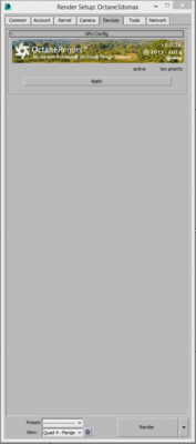

I have a nvidia titan and a quadro fx 3800. simply the octane does not recognize any of the signs cuda. drive last 337.88 nvidia.
how to solve this problem?
3dsmax 2014
windows 8 64bits
intel dual xeon x5690
54gb ram
