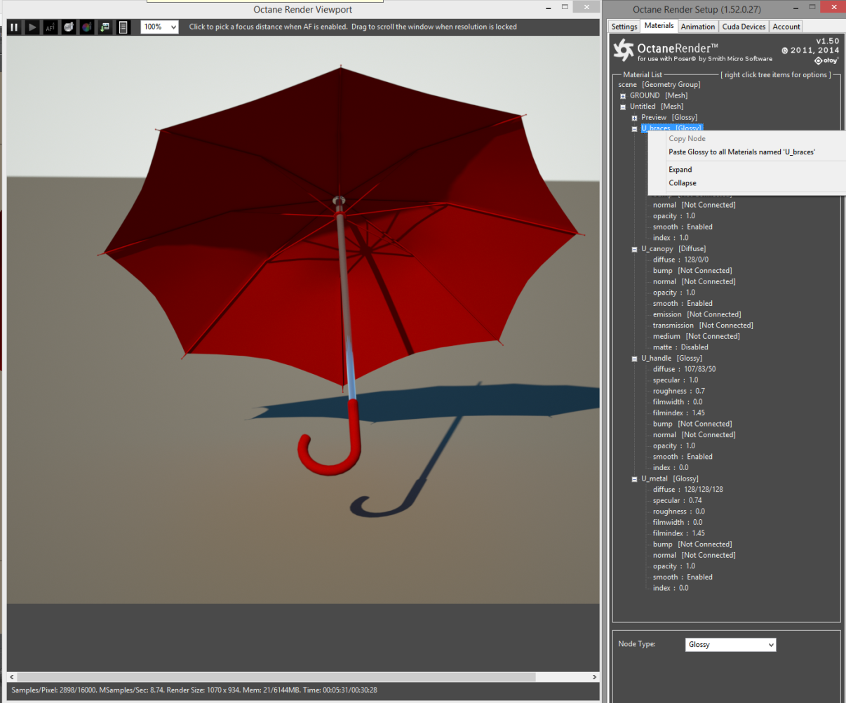

Well, export/import as 3DS did help - sort of.
I get the thing loaded into the viewport but it seems, some of the material zones are broken.
As you can see, I can adjust the metal and canopy material, but the two others are, well, disobliging. :(
Even worse, the thing is a full rigged Poser figure, so I'd like to fix the original, if possible.
I tried assigning new UV-maps with UV-mapper to the original OBJ, but that didn't seem to help.
Do you have a hint, what else I could try? I have hexagon and modo, if need would be...
I'm not complaining about freebies - but some are really annoying. :lol:
Unfortunately the mesh is broken, and in this situation your on course of action if to load the whole thing into a modelling app and re-UV map the object - taking care to not re-order the vertices, so the rigging info in Poser is not broken.

As Paul says, re-UV map the object in a 3D app - or in Poser.
In Poser use the grouping tool. Assign new material (pick the polygons to assign the new material), and then use (Create Perspective UVs) to project the new UV map to the assigned material.
The projected texture size/scale (if you want to use textures) is decided by the camera distance to the object.
