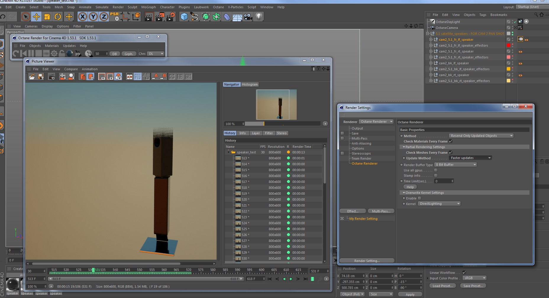

It's ok on my computer. Can you check picture?

Sorry for the late reply; the problem is now resolved on that system, and although it still happens on another PC I don't need to fix it on that one.
Thanks for your help aoktar :-)

ten wrote:What was the fix please? Anything others should be aware of ?
ten
nothing. It doesn't crashes on 1.53.
