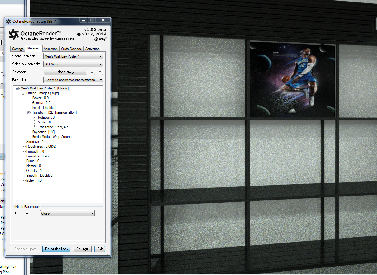

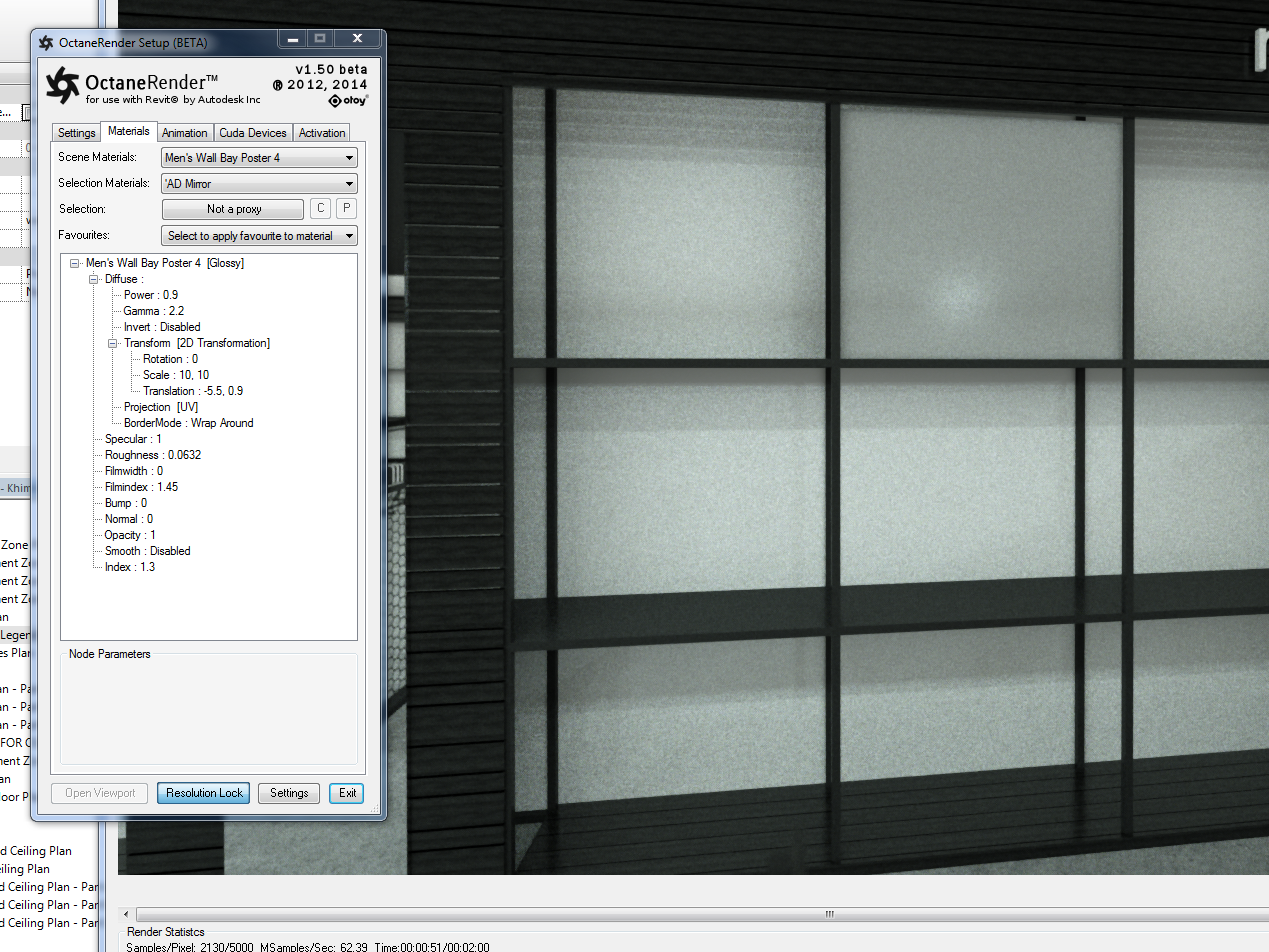

My main problem seems to be when assigning say an image which is represented like a decal. All goes well during the assigning and rendering but....
if I close the file and open again, most of the images are lost.....

Can you post a screen shot of before and after the reload pls of the Material tab from one of the materials that goes missing?
JNDesign
Posts: 187
Joined: Sat Aug 10, 2013 3:00 am
No probs
here you go

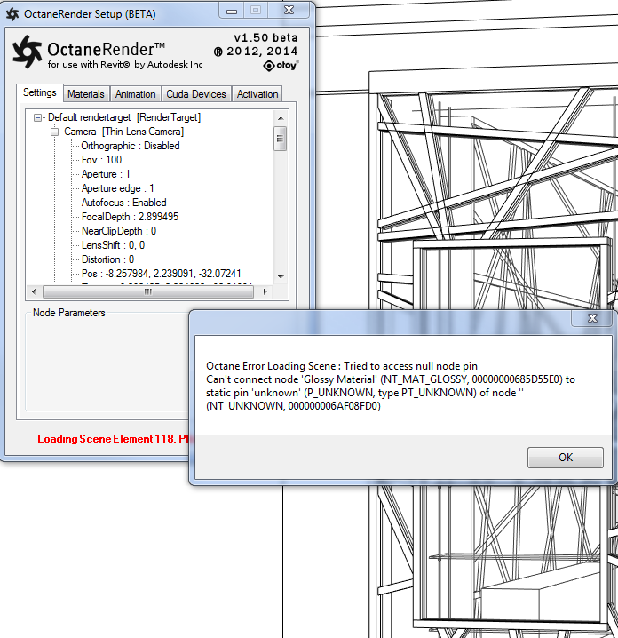

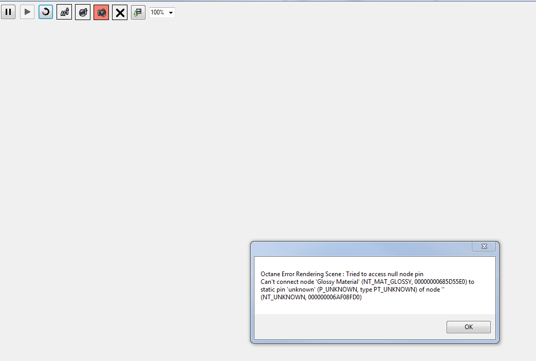

Also getting errors now in another file
