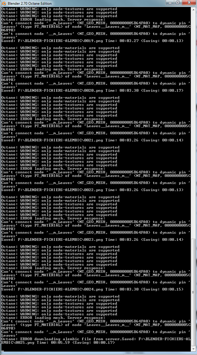

3 -The exports seem to work properly, but there are error lines in the Blender console :
Any comment about these behaviours ?

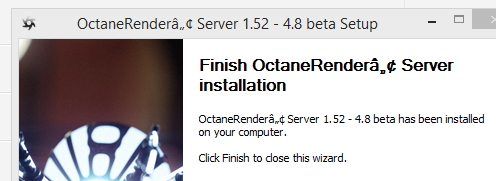

Only a small cosmetic thing atm. There's something funky going on wit the fonts/characters at install time (see attachment). Also I think I only saw 2013 mentioned on the spider picture when you launch the install exe .. :)

ROUBAL wrote:3 -The exports seem to work properly, but there are error lines in the Blender console
I will need the scene to reproduce it...
@ Jim : It is the same scene I already sent you with the animated tree. I only changed the name of the materials, because I noticed afterward that they were ununderstandable alphanumeric names (inherited from textures references generated by Onyx Garden) instead of clear names like Trunk and Leaves.
EDIT : I ran again this export of the 990 frames animated tree... I came back one hour later, and it had stopped at frame 14 without error message in the console. Blender for Octane is frozen. i have to kill the server to close Blender. :cry:
I started everything again, and launched a new export... The export stopped at frame 140 with no error message in the console. Blender was frozen again. Some lines have been added with error messages when I killed the server.
I send you the scene in PM. It is the animated tree with new materials names.
