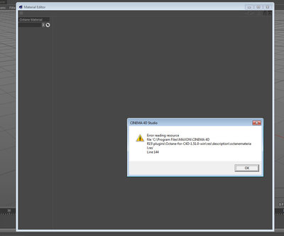

it's just a warning. I think archive has wrong resources or you copied wrong. letme. to check it
can you use 1.52.1's res directory?
