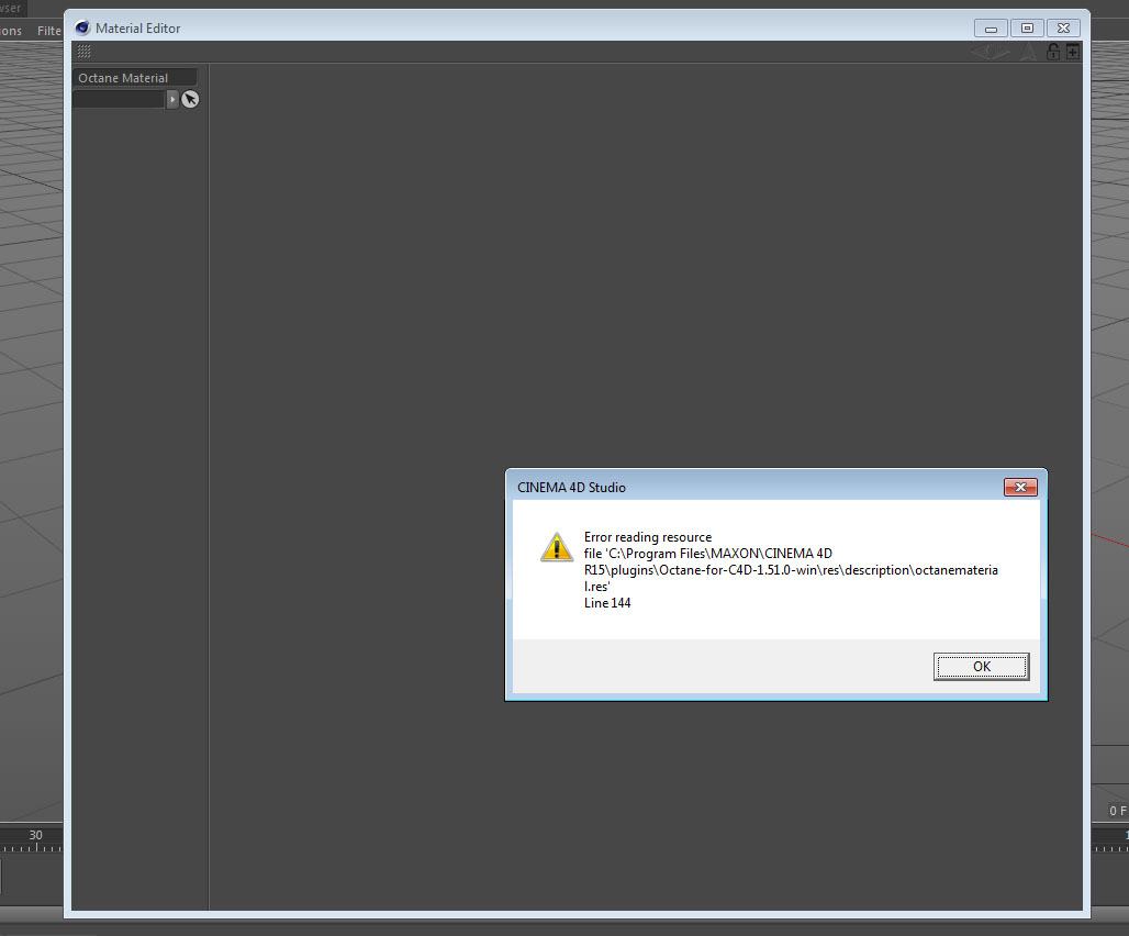

After installing your update also having problems when creating material and after this Cinema is crashed.

it's just a warning. I think archive has wrong resources or you copied wrong. letme. to check it
can you use 1.52.1's res directory?
