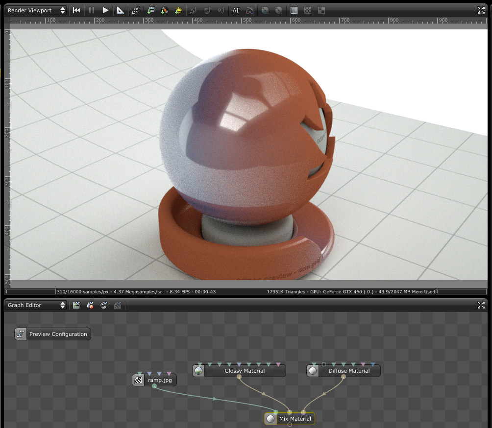

And map it to amount:
Ofcourse the texture doesn't fit nice on the preview ball, but it will on your properly UV-mapped object

Ah, cool I see. Not quite what I wanted though. I want to be able to control the mix with a procedural node. And I don't want to have to worry about doing a UV unwrap on the mesh. That's the fun thing about procedurals. :) Thanks though, that's a good idea.
