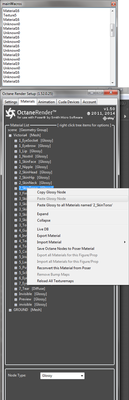

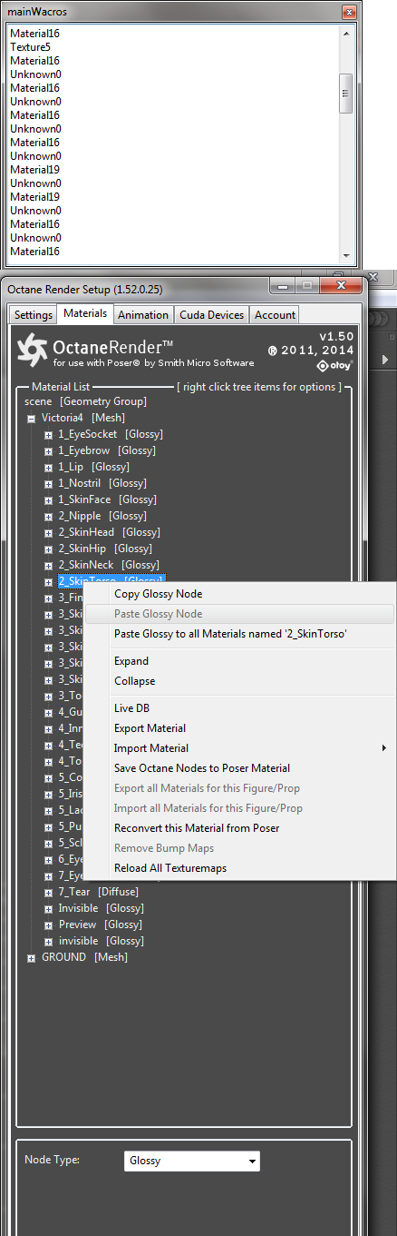

Could it be, that the copy and paste of materials doesn't work all the time? Or perhaps it's an user error...
When I copy a material (right-click "Copy <node name> Node ), e.g. the hip material of a V4 figure, which I then want to paste to the torso material of the same figure, the option "paste material ... " (by right-clicking the mat.zone, so the context menu opens) is greyed out, so I cannot choose it. Whereas the option "paste <node type> to all materials named xxxx" is available.
Also, a "mainWacros" window keeps popping up for me, with something that looks like a counter/or an information in it. Saying: "Unknown" with a value behind it, and/or Material" with a value behind it.
No biggies here, maybe just a bit irritating.
face_off
Posts: 15830
Location: Adelaide, Australia
I will fix this tomorrow. If you want the be rid of the errors - install the 1.52 STABLE release.

I have refreshed the installer at the top of this thread with:
1.52.0.27
- Fixed issue where materials could not be pasted following the 1.52.0.25 change to allow pasting of disconnected nodes
1.52.0.26
- Disabled sliders when the edit value is < 0 (to allow negative UV_Scales from Poser Image_Map nodes.
Paul
Erick
Posts: 249
Joined: Thu Sep 13, 2012 9:40 am
Update works great so far.
Thanks! :mrgreen:
