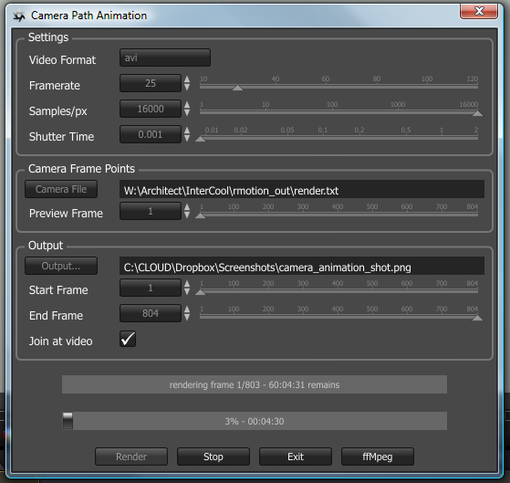

Here is a script that animates a camera from a camera-target position file. It uses ffmpeg for the video creation.

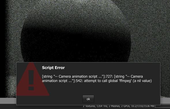

Getting error
Code: Select all
Expecting a 3-component vector
so it appears there may be an issue with the formatting
Also note that ffmpeg.exe is required but not included http://www.ffmpeg.org/download.html
Windows build http://ffmpeg.zeranoe.com/builds/

Are you putting the given data in a file and gives you this error ?
for ffmpeg the only till now solution is to be in c:\Program Files\OTOY\OctaneRender\ffmpeg.exe
i will figure later on hoe i can setup the script to find it on its own ...
( do you have the 1.50 standalone version of octane ?)
Load Animation Path.lua
with frame progress
(22.16 KiB) Downloaded 528 times

And time estimation
(22.75 KiB) Downloaded 516 times

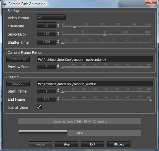

Ok fixed ...
in this version you must put ffmpeg.exe in the lua script directory
(23.81 KiB) Downloaded 924 times
