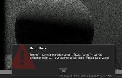

Getting error
so it appears there may be an issue with the formatting
Also note that ffmpeg.exe is required but not included http://www.ffmpeg.org/download.html
Windows build http://ffmpeg.zeranoe.com/builds/
Code: Select all
Expecting a 3-component vectorAlso note that ffmpeg.exe is required but not included http://www.ffmpeg.org/download.html
Are you putting the given data in a file and gives you this error ?
for ffmpeg the only till now solution is to be in c:\Program Files\OTOY\OctaneRender\ffmpeg.exe
i will figure later on hoe i can setup the script to find it on its own ...

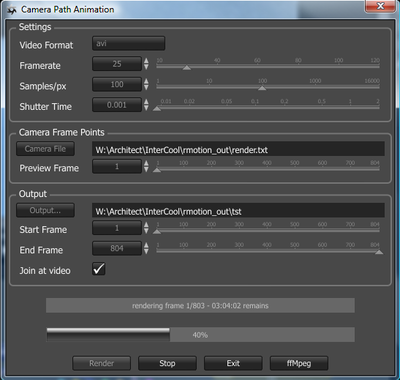

And time estimation
- Attachments
- Load Animation Path.lua
- (22.75 KiB) Downloaded 563 times

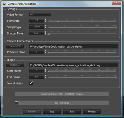

- Attachments
- (23.81 KiB) Downloaded 996 times
I think there is a problem with the command line that this script builds and send to ffmpeg, it will not handle file names or directory paths with spaces in them.
Does anyone know what the correct syntax would be to fix this.
many thanks
Mark
many thanks
Mark
