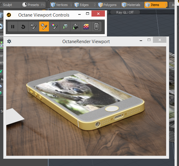

I'm trying to use a texture as a smartphone screen. Can't get it to work though. It doesn't matter if I use a texture or a Black Body.
Here's what I do.
Create a Diffuse material as na override for modo materia. I add an Octane BlackBody/Texture emmision node to the material. Then I add a texture node for the Emmision.
Aaaand nothing changes in the scene.
Here are my settings:
I get nothing (to see the offect I've turned down the environment lighting to 0.1):
What is pretty weird is that if I turn off the Octane ovverride in modo I can see the screen texture (working as a diffuse layer) - If I turn the override back on I get a black screen.

Hi. Try turning the power on the emission node up.

Also, try plugging the image node into the diffuse pin of the diffuse node.

I just had a chance to try this....
1) No, you don't need anything plugged into the Diffuse channel of the Diffuse Material
2) You node layout worked well for me - so not sure what it going on (I only needed a power of 2 to get a good result).
3) Make sure the phone screen has UV coords. Check the Modo Event Log for any Octane scene load errors.

I downloaded that scene, and it renders nicely for me. Total scene VRAM requirement is 630MB, which is quite small. Total polys are 3.7 million, which is no problem. What hardware, video card and nvidia drivers are you running pls? If your graphics card has issues - powering off your PC and restarting can sometimes get things started again. If you are running 2 cards, make sure SLI is off.
Regarding the emission - there is a glass cover over the phone, so I can't get to the surface that is emitting the screen image. But at a guess "szklo" is the glass - and the Octane Override for it has been corrupted - so delete and recreate that override and set the "Reflection" for the resulting Specular material to about 0.2.
I'm guessing "ekran" is the emitter. You need to load a image name into the Filename channel of the Octane RGB Image, an also click the Texture Locator node and select the image in the Texture Locator Properties so it picks up the correct projection. This will be better handled in the next release, which will automatically build the nodes to handle an emission based on the texturemap in the Modo material. I set to emission power to 20000.

Hello again Paul. Thanks for your test on the scene. I think there was smth wrong with my graphic driver, I've just reinstalled it with a "clean" install (335.23) and the scene loaded fine! I'll try to recreate the screen emmiter the way you described.
You were right about the materials - the "ekran" is the emmiter and the "szklo" is the glass cover.
Thanks again, everything is looking good now
