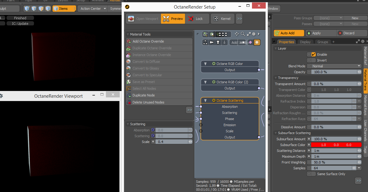

You probably already tried this, but in the GI render settings, Indirect Illumination needs to be changed from the default of Direct. Indirect Affects SSS or Both will take into account Environment lights.
I still can't really make this work for me (see below). Ideally we want a scene with IBL lighting set to 100% power, with an object with scattering which can be used as a visual guide to determine the Modo scatter distance to Octane scatter scale factor.
