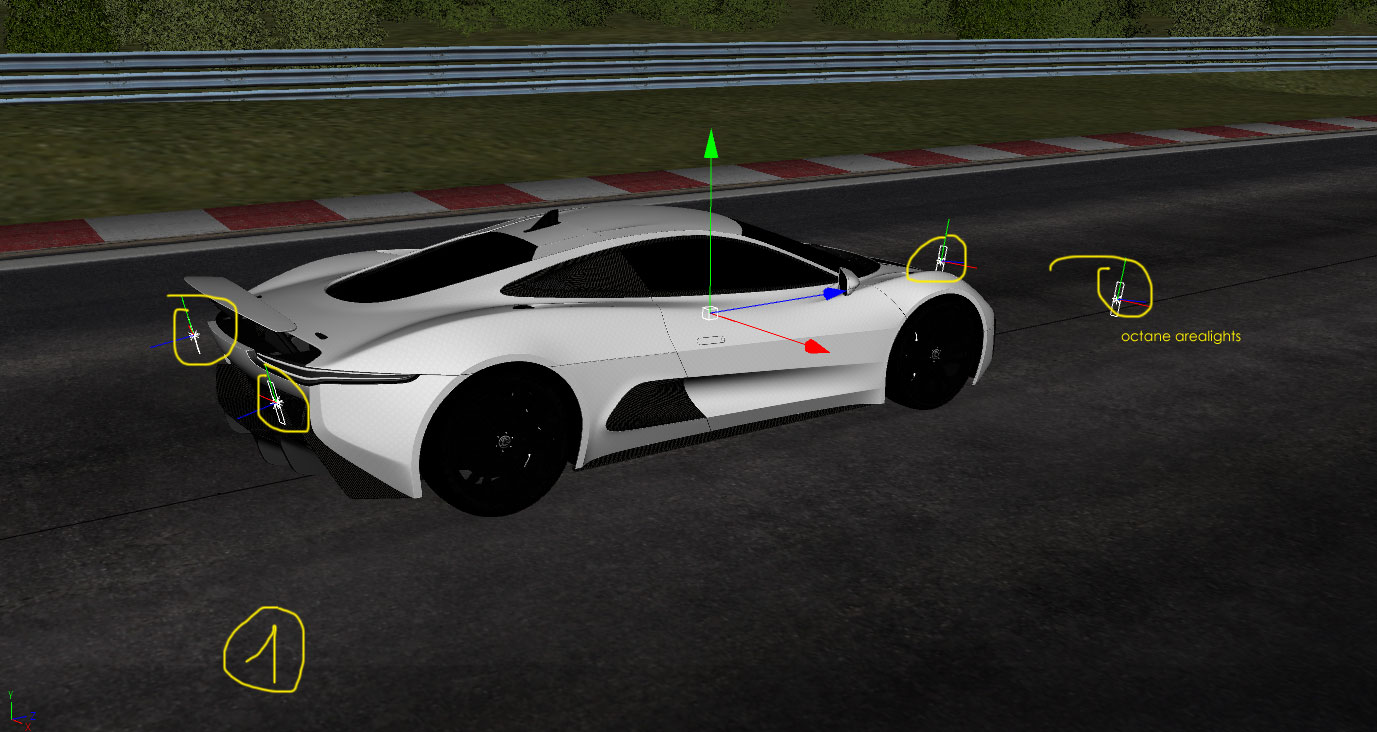

The back and front lights are simple octane arealights. See attached image "jaguar_octaned_lights"

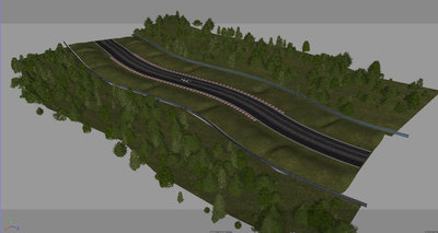

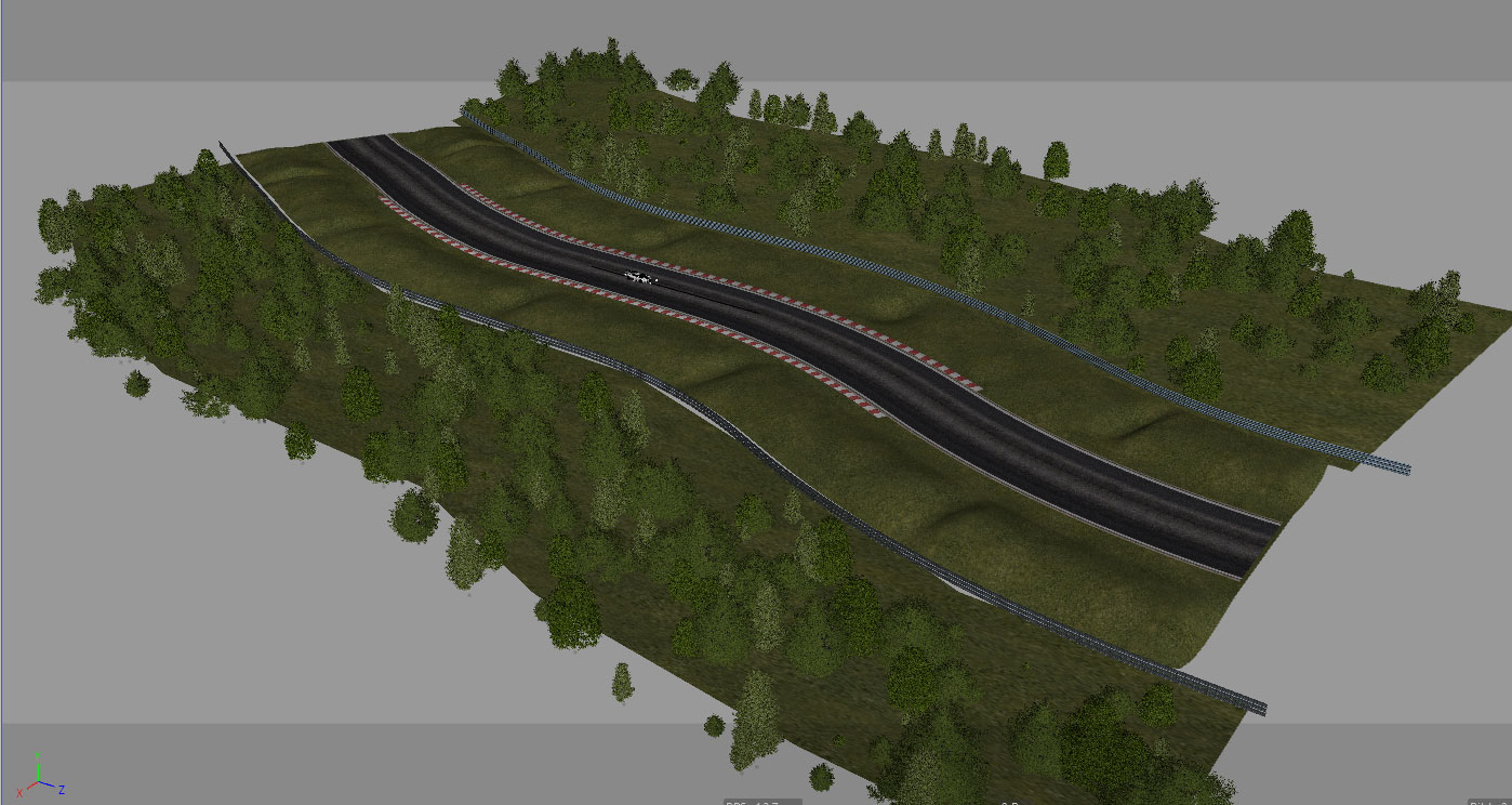

The scene itself is a mixture of Closeup surrounding geometry and HDR. See attached image "jaguar_octaned_racetrack"
