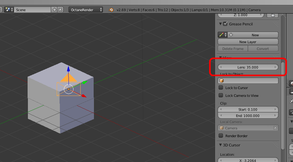

Toast wrote:But in orthographic mode the camera distance shouldn't matter
Id does matter for Octane. So, for ortho camera - you can play with this setting too:

Sorry I shouldn't have said 'camera', I did mean just viewing in the viewport (not through a camera). Changing the clipping distance sorted it. I had to do it in the properties panel (N), not in the camera setting though. It does still clip, but only when you're very close.
