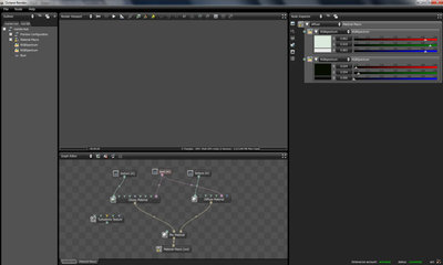

Here's the contents of the macro right before Octane crashes. It doesn't appear to be due to an image.
As far as naming the nodes, just type in the Node Inspector and hit the enter key to make the node retain the newly typed name.
I was able to recreate the basic setup that you produced and it worked fine. Try it again from scratch to see if the issue goes away.
You can download my example here: (Right click, save target as...)
http://www.refractivesoftware.com/downl ... tScene.ocs
Win7 64| Two GTX 470s | Phenom II 920 | 8 GB
Win7 32| GTX 260 | Athlon X2 5000+ BE | 2 GB

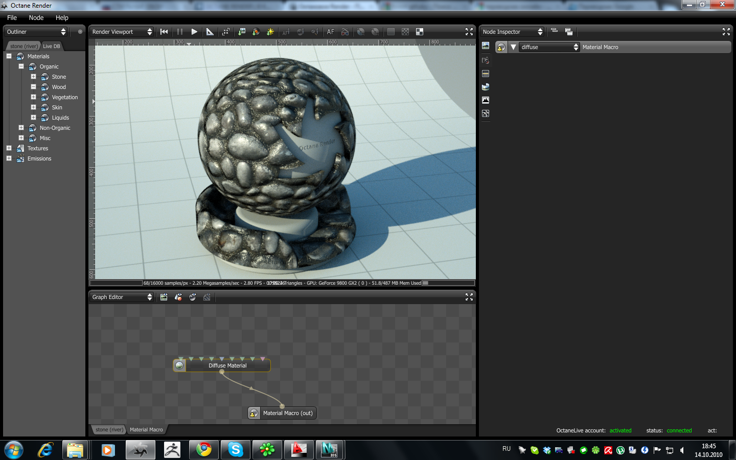

Elvissuperstar007
Posts: 2545
Location: Ukraine
also can not upload
