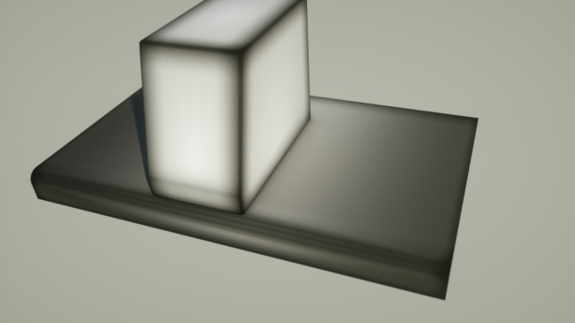

In thin objects, it seems to pick up the other side of the object, as can be seen on the flat part of this test object (the box on the top is exactly what I want it to do).
If I really reduce the radius I can almost get it to work, but then the effect is not pronounced enough on the box.
Also, as you can see, it picks up the edges of the rounded corner which is obviously not disirable.

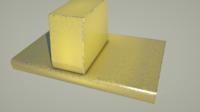

I use it to mix with a procedural and then to mix materials like the following, but you can see the effect is ruined by the flat bit.

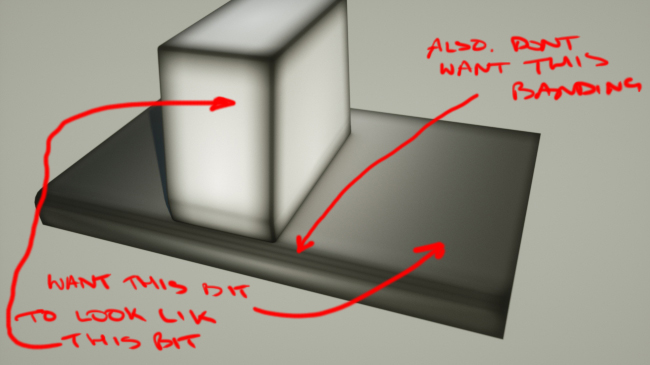

Dont think I've explained myself as the settings don't matter. The flat bit and the box are always completely different.
Hopefully, this image explains both problems better.

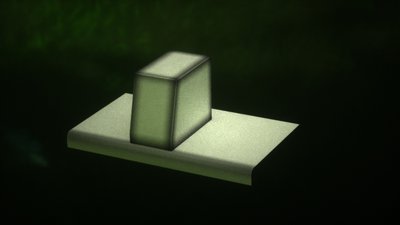

I guess I'm still not clear, Gordon,
I get this, with a very green pic for the environment texture.
i7-4770K, 32gb ram, windows 8.1, GTX Titan and gt 620 for display

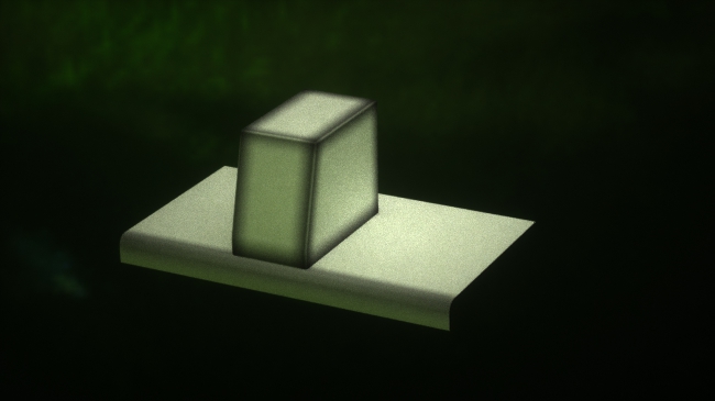

Like this:
With a texture:

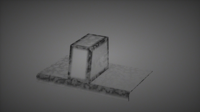

And you haven't changed the nodes for the bottom bit?
What version of the plugin and LW are you using?
That looks nothing like what I've got.
