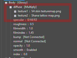

face_off
Posts: 15830
Location: Adelaide, Australia
The plugin is going to grab the texturemap from the Poser "Image_Map" node (which is hard to identify because that node is closed on that screenshot). The Poser nodes are then merging the standard (V4?) image map with the tattoo map in the SWP_ShanaC_Math0 node. Again - hard to tell what that node is doing without it being open. If it's a multiply node, you can do exactly the same thing in the Octane plugin. Change the Diffuse pin to a Multiply, put the V4 skin texture in Texture1 and the Tattoo map in Texture2 (both as RGB Image nodes).
IMO, you will get a superior render by using a skin texture which has the tattoo's on it already, rather than a product which merges the tattoo with another skin texture.
Paul

fallen21
Posts: 29
Joined: Fri Nov 23, 2012 5:36 pm
This way is working but if i do that the part of the skin with the tattoo map is different than other parts.

face_off
Posts: 15830
You will need to do the "Multiply" setup above inside whatever skin material node setup you are using for the figure (ie, don't just use the above material because it is different from the other Octane skin material zones). So whereever there is a normal skin texturemap connected to a pin, replace it with the "multiply" above.
Also, that "multiply" method posted was a guess - if you post a screenshot with the SWP-Shana node opened, I can get a better idea of what the Poser material is doing.
