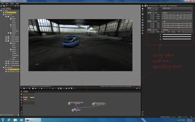

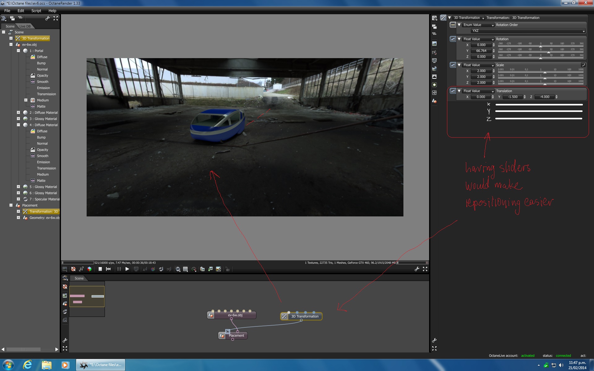

However I would like to ask for Translate sliders. I did question this once before. These would just make life a lot easier when repositioning geometry 'in' a background scene to the artists satisfaction than entering numbers.

pixelrush wrote:However I would like to ask for Translate sliders. I did question this once before. These would just make life a lot easier when repositioning geometry 'in' a background scene to the artists satisfaction than entering numbers.
Use shift or ctrl to speed up changing the numbers - for me it is better than sliders.
I agree with Pixelrush. Having Translate parameters displayed differently than others makes the GUI less cumbersome, but it is disturbing in the workflow.
Translation goes from -inf to +inf. We support "out of range" sliders (for example lens shift on the thinlens camera) but what range should we display? A useful range for your translation depends on the scene you're working with.

Well in the example above I was moving the vehicle around the scene by just a bit, a few metres. I think for most people this would be the case ie they are repositioning/rotating something near to the camera to be a little more photogenic so I suspect usually say <20m but perhaps 2000m is enough max. This could perhaps allow a 747 to be moved around an airport terminal...dunno.. :roll:

Sorry, but I have to disagree. Pretty much all 3D applications don't use sliders for positions and most of the time also not for scale and rotation. And there is a reason for that: Sliders clutter the UI a lot.
In the mid-term we would actually like to un-clutter the user interface even more, which probably means even less sliders. You can have a similar behaviour like a slider either using the scroll wheel over the numeric field or holding the mouse button down and moving the mouse up and down. You can increase the speed with the SHIFT modifier 10x and with the CTRL modifier 100x.
