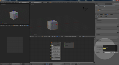

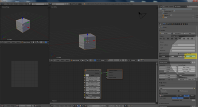

Select your grass blade and change its mesh type to "Scatter". In the render settings, set the mesh type override to "As is" (preferably) or "Scatter".
Mesh type of the grass blade
Render settings - mesh type override
Hope this works for you
