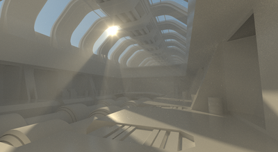

Hello everyone.
Can you please tell me how can I increase strength of volumetric lights? I'm using just a simple specular material with IOR = 1 + small subsurface radius (mudium node).

You're already on the right track! All I can say is turn the Scale up in the scattering node (maybe by a factor of 5?) It may start to seem hazy, to counter this, you may want to darken your materials a little bit or adjust the gamma in the Imager settings.

Unfortunately scale didn't solve my problem :(

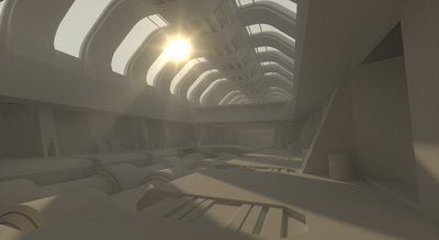

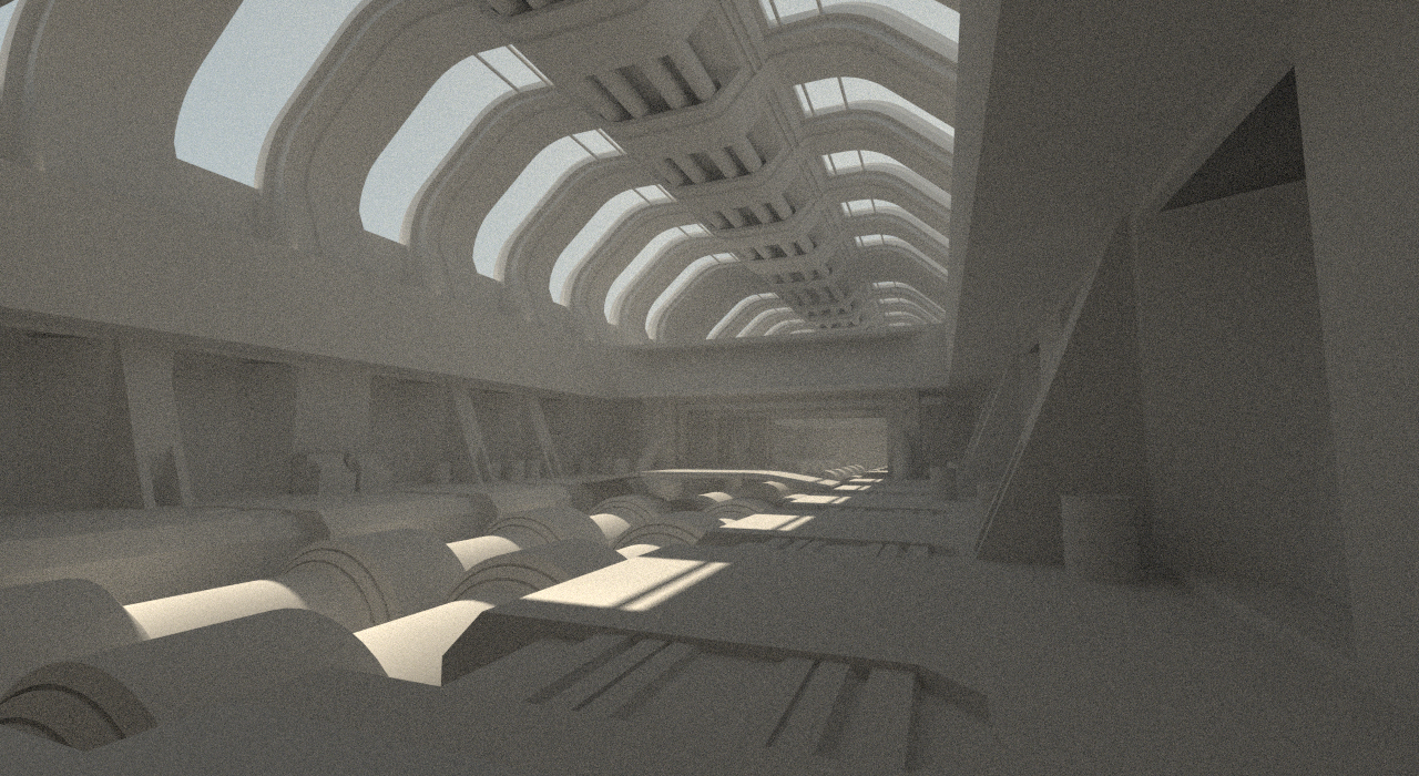

Here I do not see volyumetrics :shock:

Hmmmmm, scale is supposed to directly affect how much effect the volume has, strange that it doesn't. Can you post a screenshot showing your material and render settings? Also if your daylight has a high turbulence, your sun is pretty dim in comparison, make sure it's at 2 for maximum brightness of the sun.
I've gotten strong light shafts before with the right settings.

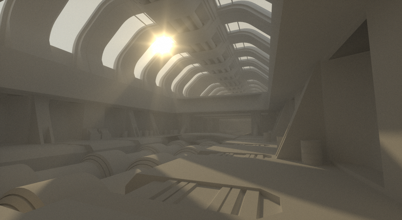

I think I've already fix this. Here is result. Problem was as I understand in scale of fog shape.

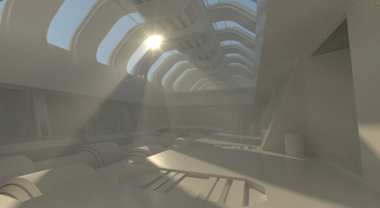

profbetis
that scene with the light through the slats is great. Any chance you might share it. I have notbeen able to get strong rays like that and have tried a few different settings.

Sure thing P3taoctane. It's a fairly simple setup. I used portals in the windows to aid in fast rendering.
However it is in 3DS MAX 2013. Hopefully that's usable to most people. You need to make an inverted shell that goes around the camera so that it's not inside the volume.
lightshafttest-profbetis.zip
Mess with SCALE in the fog material!
