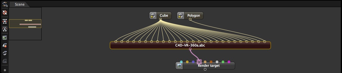

So you imported an Alembic file, only to get a single material input called "Material"? You can disable merging of materials, but now you have 100's of input pins for all the objects in your scene. At least we can give every object its own material.

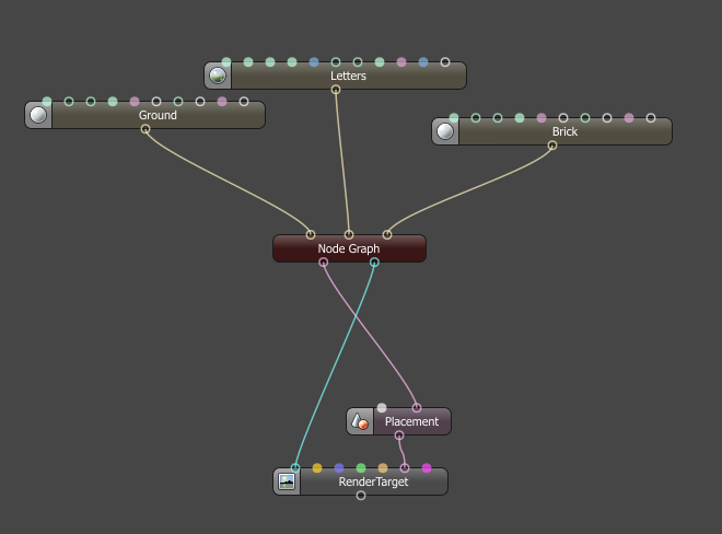

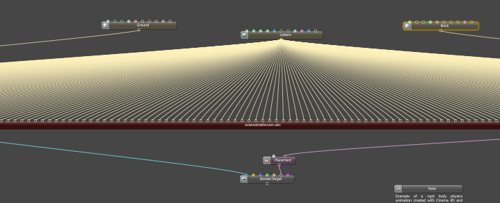

Oh dear. If only we could make it look like this:
Today we will wrap the Alembic node into another node graph, and then we can hook up all inputs which should have the same material with one input linker of our wrapping node graph, so we avoid a lot of spaghetti on the outside.
