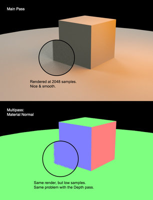

I have a problem with the quality of the multi passes.
When I render via Directlighting with high samples and activate the multi passes as described before, the multi passes are rendered with low samples (even when I set them high as well in the Deep Channel settings):
What am I doing wrong?
Posts: 16068
Location: Türkiye
For quality, need to set maxsamples of deep info kernel to higher values.
This is what I did. I set both samples (Direct Lighting + Deep Channel) to 2048, but only the main pass was rendered like that. The multi passes appear to ignore the sample settings and render lower.
