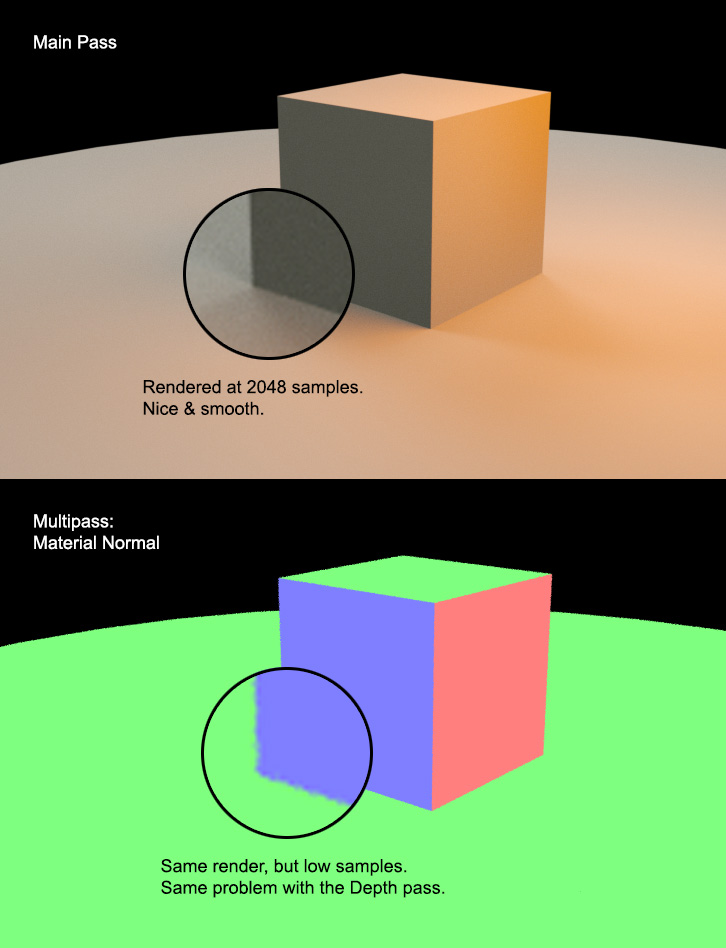

I have a problem with the quality of the multi passes.
When I render via Directlighting with high samples and activate the multi passes as described before, the multi passes are rendered with low samples (even when I set them high as well in the Deep Channel settings):
What am I doing wrong?

For quality, need to set maxsamples of deep info kernel to higher values.

This is what I did. I set both samples (Direct Lighting + Deep Channel) to 2048, but only the main pass was rendered like that. The multi passes appear to ignore the sample settings and render lower.For quality, need to set maxsamples of deep info kernel to higher values.
