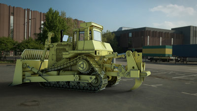

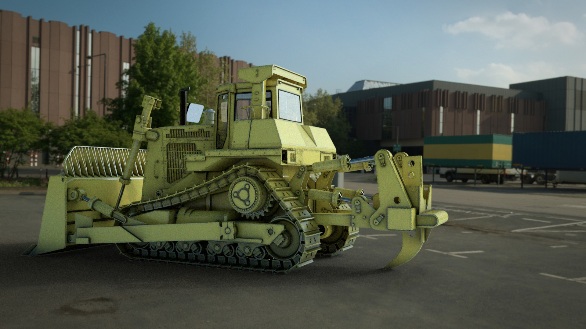

That works quite well for the basic use of Gradients, thanks Beppe.
Tried it on this shader, just to make it dirtier towards the bottom.
